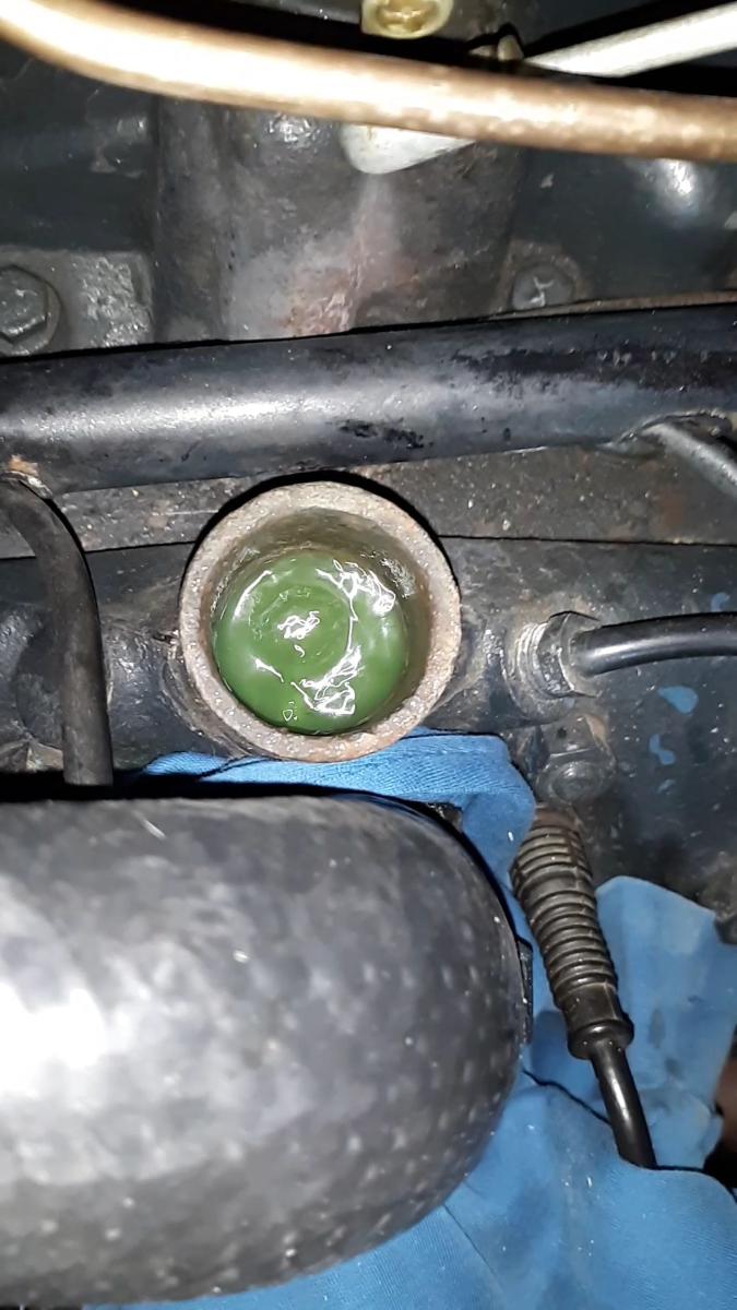

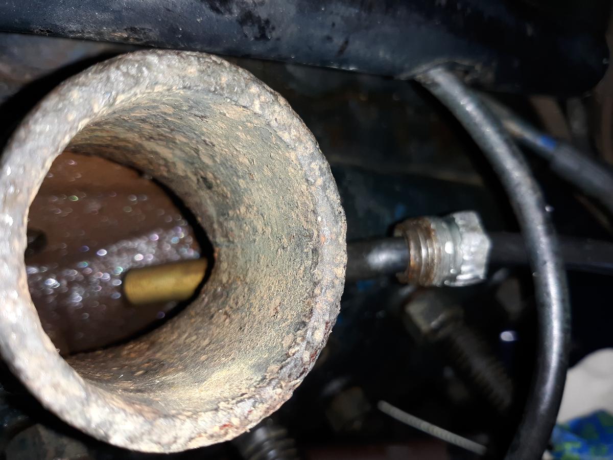

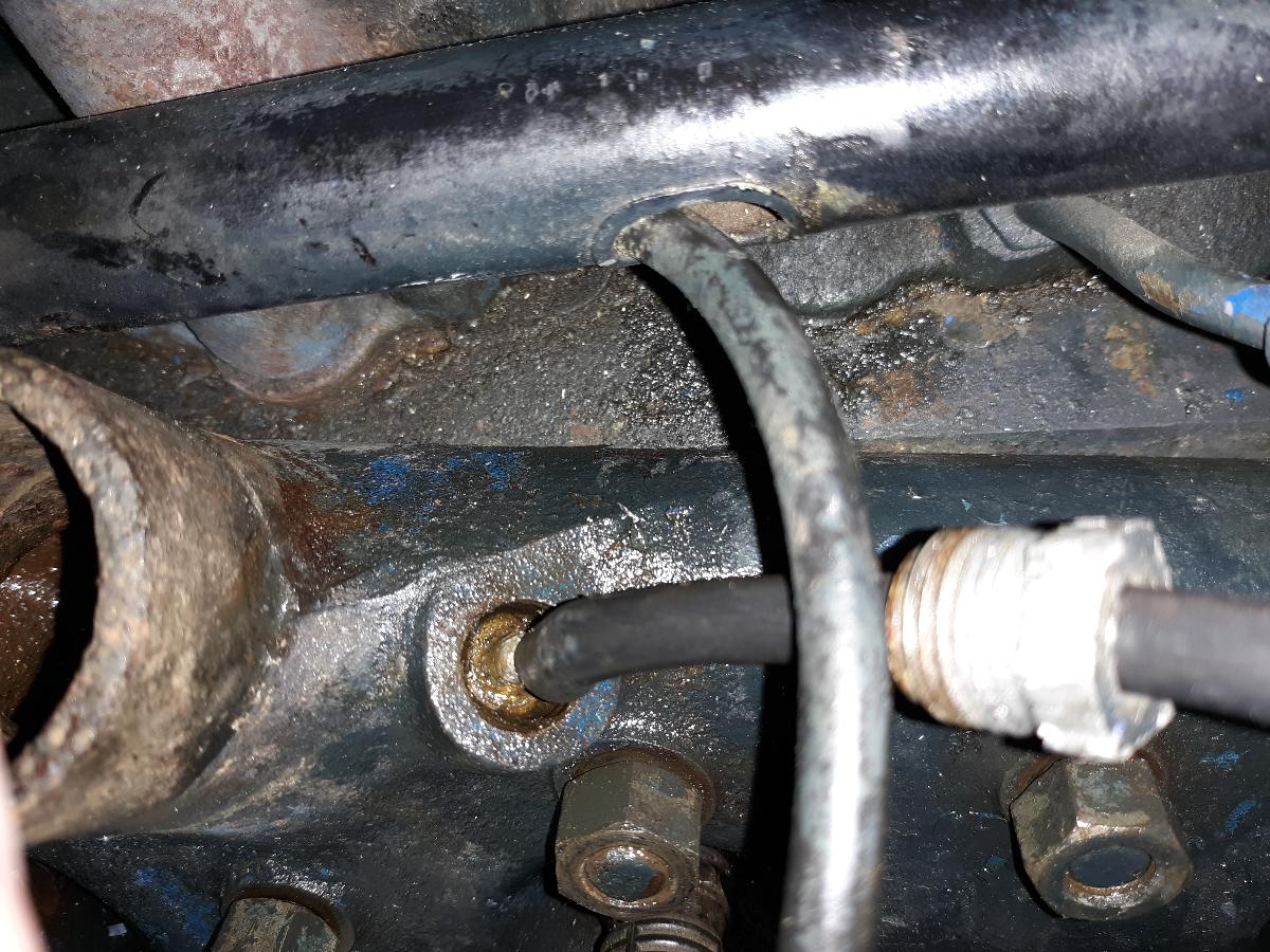

The threads in the head are NPT, the threads on the compression nut on the gauge are standard machine thread. I am surprised there was not a coolant leak! If there was someone may have used some type of glue to get it to seal??? Suggest you use a tool through the larger radiator hose connection point to see if you can get the gauge bulb it to loosen. and then remove it. When reinstalling Ford had a special fitting for this exact purpose. I think Third Gen Auto or NAPA may have the brass fitting.
05-06-2021 @ 5:29 PM
You can try using vinegar to dissolve the calcium deposits holding the temperature sensor in the head.. You may have to add the solution several times to loosen the sensor. If that doesn't work try Evaporust, their site says it doesn't hurt brass.

2) The temperature sensor on the driver's side head is stuck in the head. I was able to unscrew the large cap nut with the hole in it, but the brass sensor remains stuck in the head. It's in there so tight that I think someone glued it in because the big nut certainly isn't holding it in now. I put a heavy dose of Deep Creep on it and gently tried to push it up with a large bent screw driver but it's still stuck in there. I took a couple of pictures of it for you. Any thoughts? Thanks!
