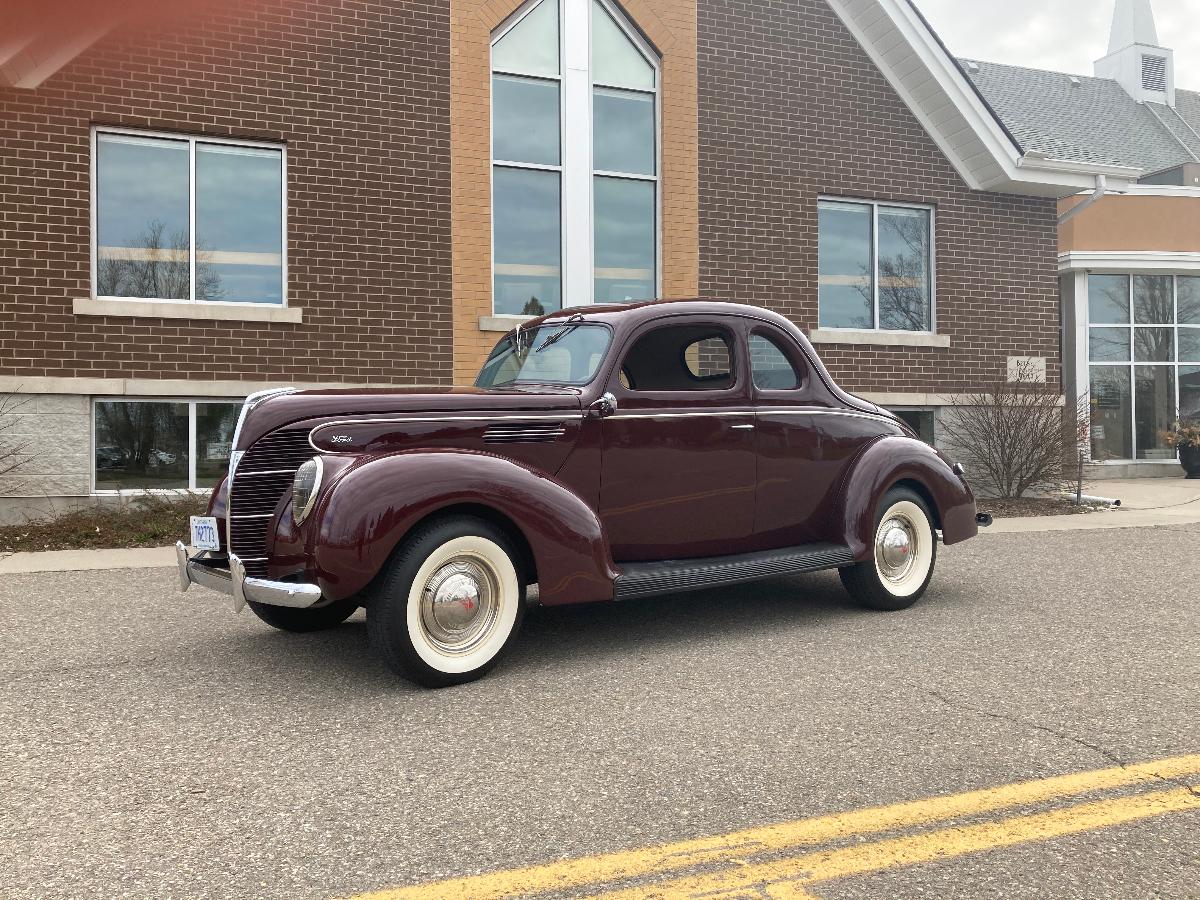

A very interesting example of the transition from mechanical to hydraulic brakes. So which is this one? One would expect the Deluxe to have the first hydraulics on a Ford. Does the Standard shrink from this? The sheet metal is interesting. Anything else that distinguishes it from a 1938 Deluxe or Standard?

I’m really not sure how original it is. It does have juice brakes.

Hydraulic brakes were standard on all 1939 Ford cars. The 1938 Ford had a body more similar to the 1937 body and different grill than the Deluxe. The 1939 Ford had the same body as the 1938 Deluxe and a similar grill. The main visual difference is that the 1939 Ford had stainless trim on the grill bars. The 1939 Deluxe used the same body, but the grill and hood are completely different.
