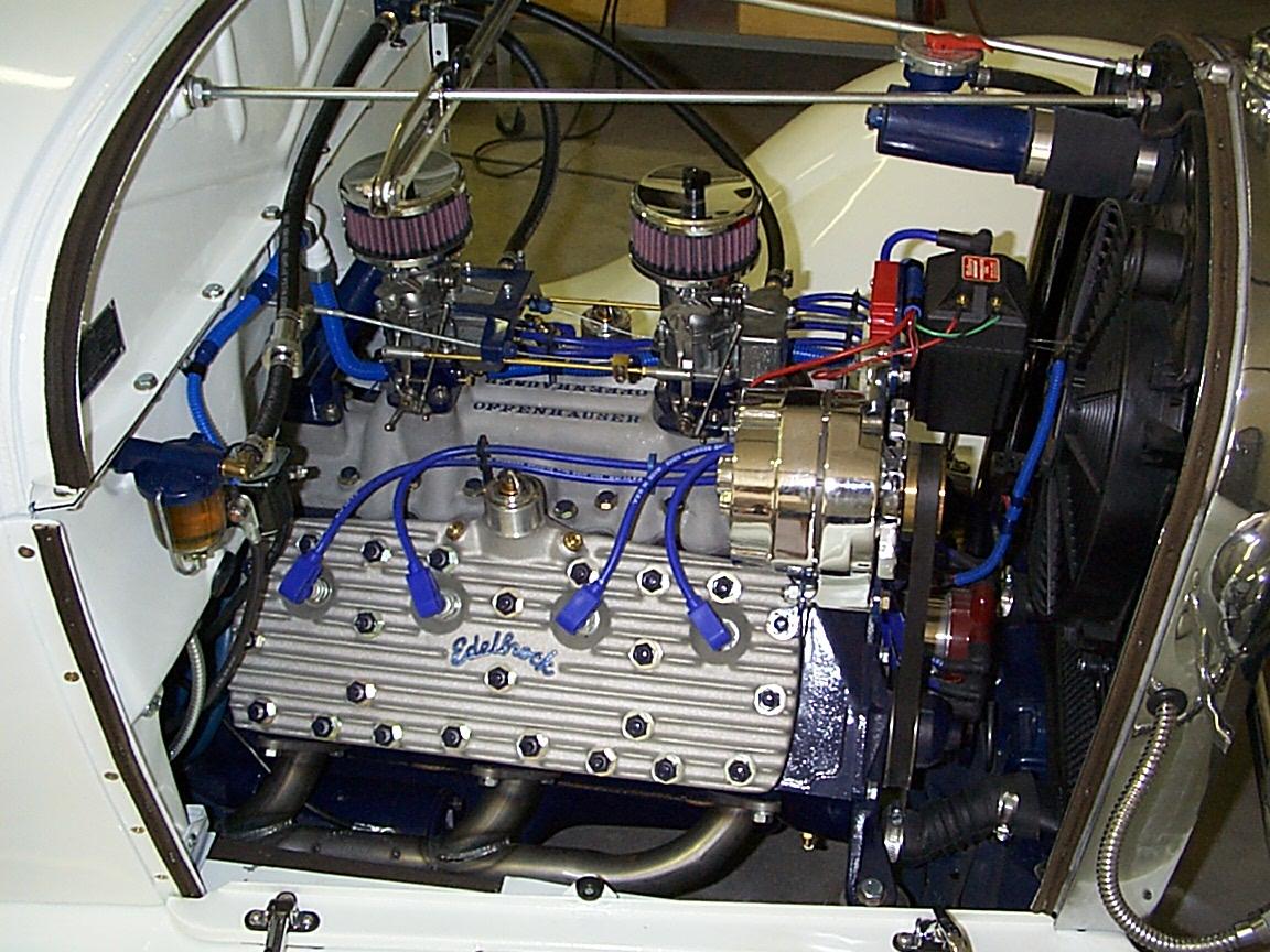

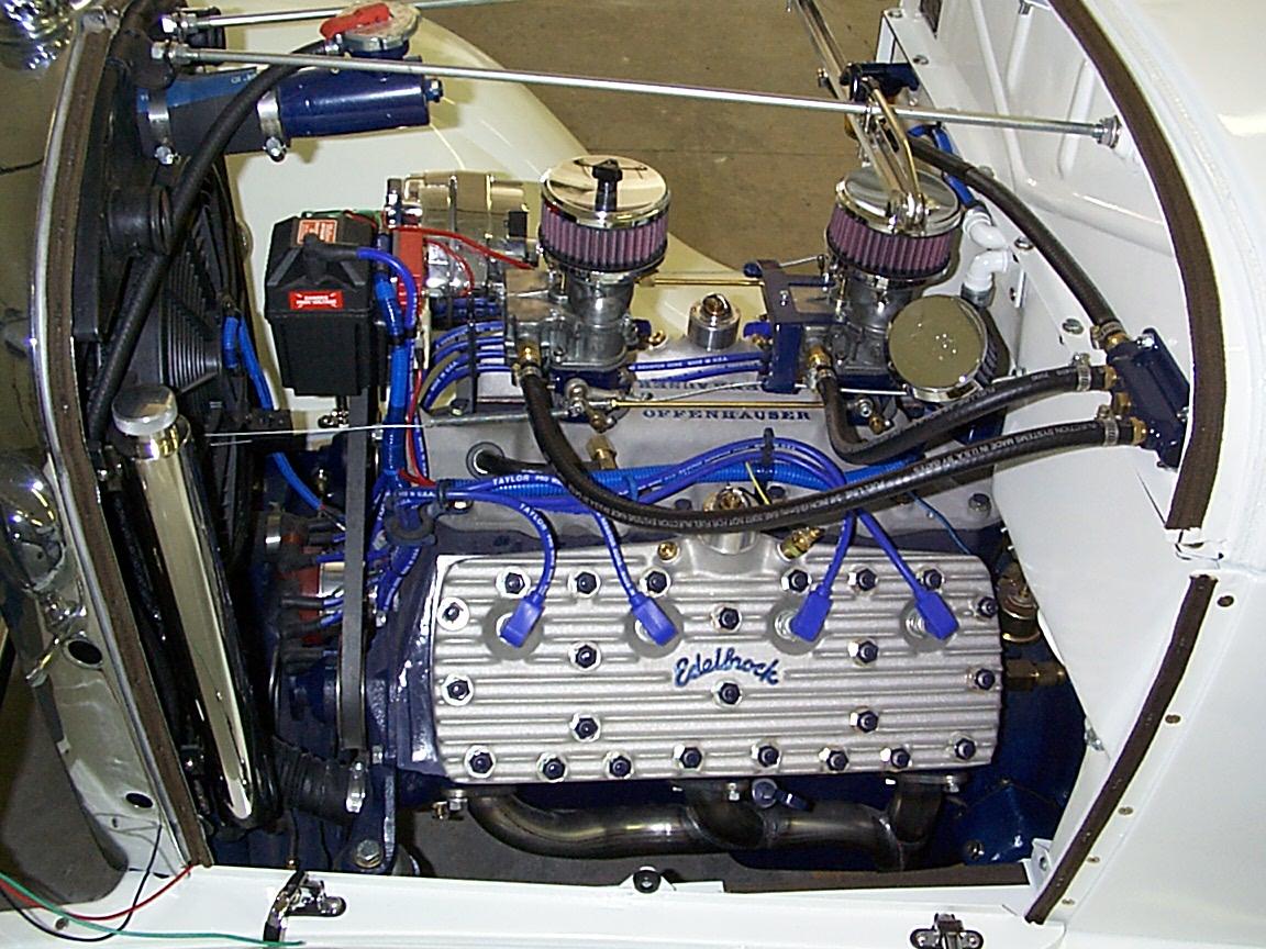

The photo shows the coolant outlets on the heads plugged, and the radiator unconnected, so it not possible to determine how the system is set up. I am assuming that you are not trying to run the engine that way. I am not a big fan of electric fans (no pun), but there are several places to check. How is the fan operated, perhaps a thermal switch, and where is the sensor placed? Is the fan actually pulling air through the radiator? There are two types of fans, push and pull, and I have seen the wrong ones installed. The engine is beautiful, and I am sure you are anxious to see it on the road,

It is not clear to me how coolant is supposed to circulate back to the engine. I see bottom hoses that feed coolant to the radiator and then what? How does coolant get back to the engine without the top hoses?

I have not seen the car recently. I am flying to Utah in late May. The photos of the engine were taken by my father during the build. I'm sure he connected the heads to the top of the radiator. Current photos do indeed show hoses between the heads and the top of the radiator.
