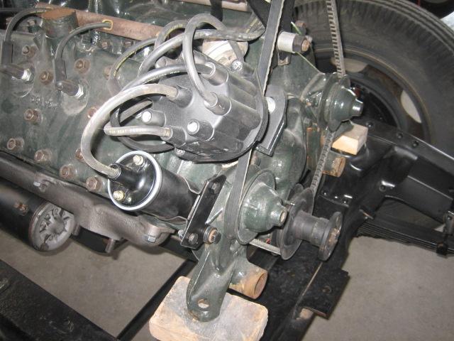

The very first thing I do on the 49-53 Loadamatic distributors is REPLACE them. Lousy design. I have the machine capabilities so use a Chevy distributor with the external point (dwell) adjust feature.

The stock distributors on the 1949 through 1953 Ford Flathead V-8 engines are dependent upon a venturi vacuum signal from the original Ford carburetor to provide the proper spark advance for the engine. If you replace the original Ford 2V carburetor with a Holley 390 CFM 4V carburetor you will not be able to provide the proper ignition advance for best running of the engine without also replacing the distributor. In order to get the proper amount of spark advance at all engine speeds and loads, you will have to replace the original distributor with a custom one that features both centrifugal and vacuum advance mechanisms.
