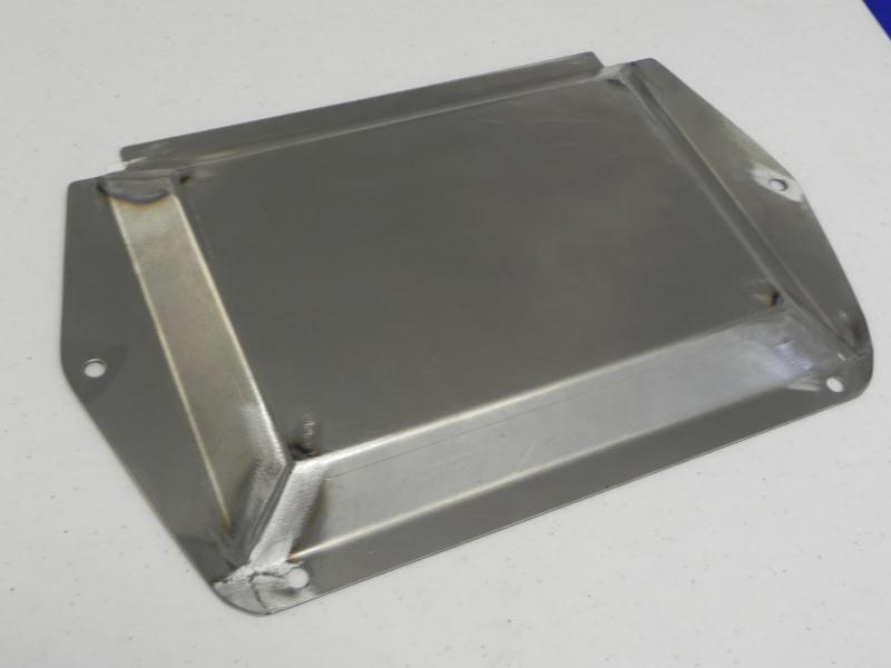

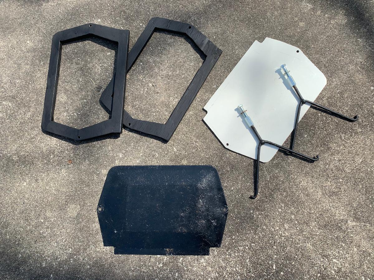

I used the steel floor battery cover plate as a template to cut and paint plywood shims to fit. The shims raise the floor cover 1 inch, enough extra clearance to allow modern Napa commercial 6v battery. Coupling nuts extend the hold-down brackets. Looks and works fine, floor mat covers perfectly.

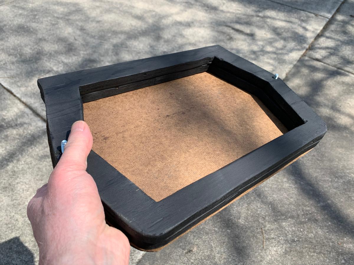

I have an Optima in my 47. To use the stock battery tray, I have a wooden box to hold the battery from corner to corner. To help the appearance I painted the box black and routed the top to resemble a regular battery, with holes for the poles. Three plastic caps completed the appearance. I did have to fabricate longer hold-down bolts as the finished box was a bit too high for the bracket. As for a cutoff switch, I use the common "green knob" kind that sits on the battery pole. Inexpensive, and if you want to prevent theft, just unscrew the knob and take it with you.
