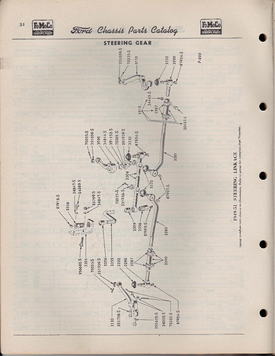

Steve, I could not tell which part had movement from your post. Here is the drawing from the Chassis parts catalog. Please indicate by P/N which part has movement.
If it is the tapered shaft that fits into the pitman arm, and the nut is tight, both the pitman arm and the steering arm should be replaced.

I very clearly stated the it was the joint at the end of the pitman arm to the tie rod.

The pitman arm connection on part #3304, Center Drag Link) I fixed it already by replacing the part. Thank you any way!
