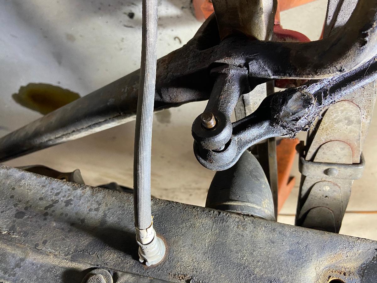

Thanks for the input. I am trying to remove the original shock front left. Bolts to the chassis are removed. The nut holding the dog bone link to the pearch that goes through the wishbone and axle is off. But that bolt will not come out of the perch. Is it just jammed and need to be hammered out or is there a secret to remove it? Thanks to everyone. This is my first 1936

Mike Denbar 1936 shocks you need to get a pickle fork to remove the link. these are pretty cheap and come in handy it might ruin the link, but new links are available , I would have the original FORD shocks rebuilt so car keeps it value you will only have to do it once, putting tube shocks involve more work, in the rear for sure, adding other brackets my 2 cents 37 Ragtopman

Thanks for the reply. I figured it out that the bolt is tapered. Both are out. Having originals rebuilt. Seems that unless you want to rod the car there are too many problems. Originals will see me through the end of my driving days. These forums are great. I do fire engines and the one I have been doing is a one off. So totally on my own and I make parts because nothing is available. Nice to have more experience to talk to. If you need help with your fire engine, holler. Mike
