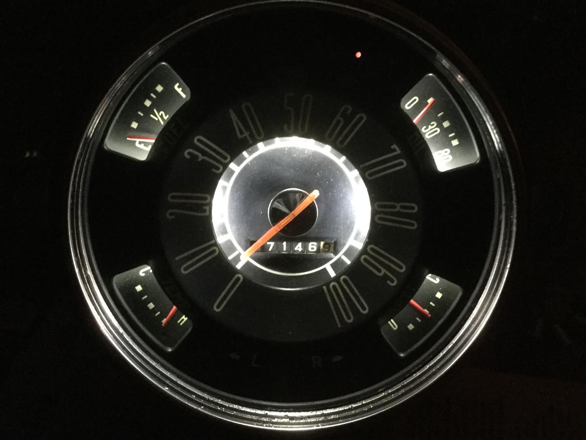

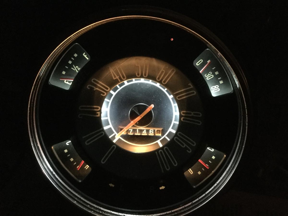

I have an extra '50 cluster that I have been experimenting with. I removed the filters and the originals bulbs works a lot better. Then I removed the original bulbs and used clear LEDs and they also looked good. You can see the difference in the pictures below. I will need to install a shield around the bright lights indicator though...as you can see. When I lose a few more lbs....I'll attempt to install this cluster in my car! LED lights on the left and original bulbs without the filters on the right.
