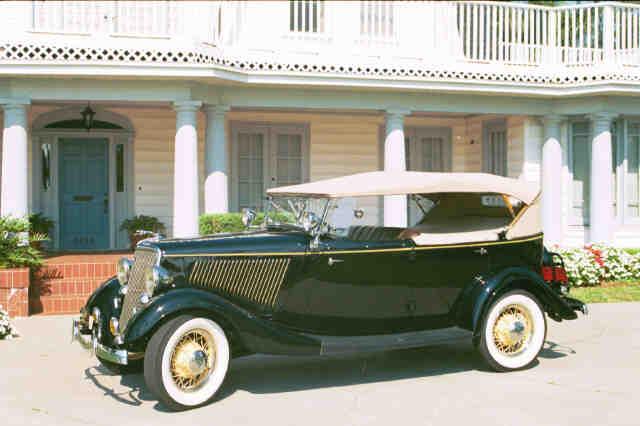

The doors on my ‘36 are both “hung”
from the same upright post at the center of the car.Over the years, these have loosened and the post swings widely upon its bolt or pin (or whatever it is). It’s really not a problem, unless both front and rear doors are open at the same time and then it takes some doing to get it all back In place.
Has anyone else dealt with this issue? I was hoping the last mechanic to have it up on a lift could just tighten up a bolt on the car’s underside and that would take care of it. He said though, that I’d need to take it to an auto body shop.
Is there anything I should know before having this work done? Any advice? Can I take it to any old body shop, or is it not so simple a repair?

John, Is this car the Phaeton that you posted a photo of?
If it is only the rear door is hinged to the center post. The front door latches to the post.
If your post is moving around, there may be structural rust in the floor. I would take the car to a restoration shop that has experience in cars from the 1930's. An improper repair could affect the way the doors and top fit.

Yes, it is the same car (Soft top) as the picture I posted. And yes - of course! - only the rear door is hung on that “floating” post. I spoke without thinking.
