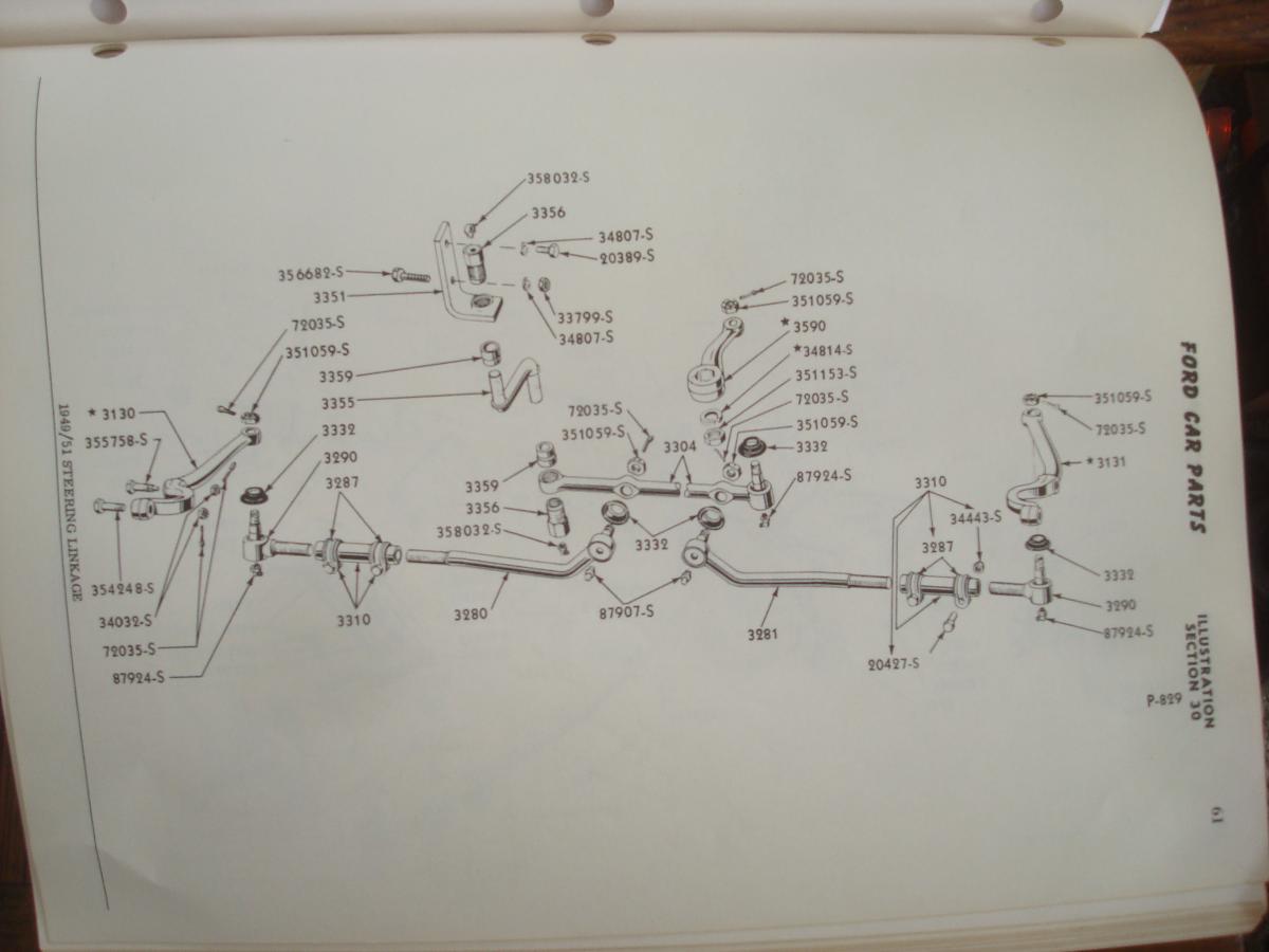

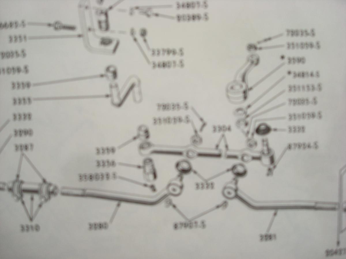

hi Steve
I have a genuine FORD MANUAL for the 1949 1950 1951
and supplied 2 photos of the steering linkage,
seems to me the only toe in adjustment is with the tie rod adjustment,
the drag link seems it is not adjustable,
but maybe I am missing something,?
hope this helps,37Ragtopman
