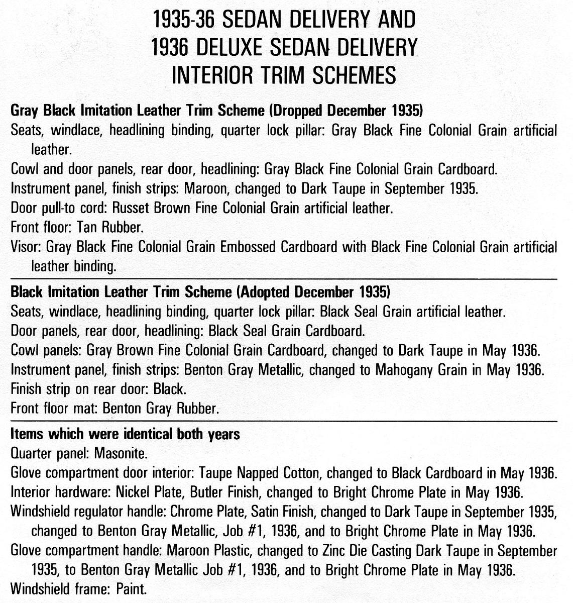

Briggs, I know that you would like comments on correctness for your 36 Sedan Delivery, but I need to know your plans for the restoration. I know you want to make the delivery like the original one shown in the photo. Are you going for close enough or an exact replica of the original vehicle?
Here is a spec sheet from DeAngelis' The Early Ford As Henry Built It. This will give you an idea of some of the changes that will need to make.

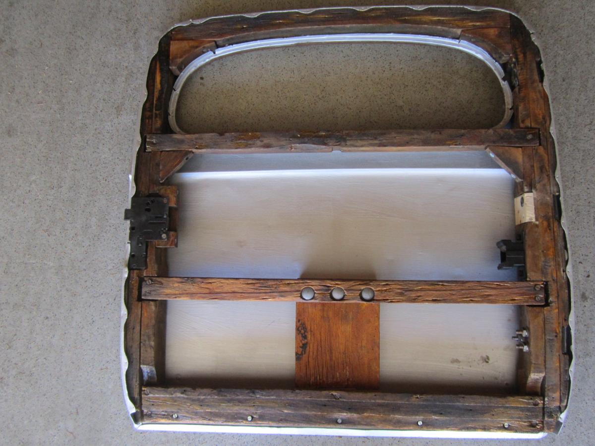

Thanks for the info. I'll keep looking for a sample of Beneton Gray. I was able to find a finish carpenter to cut out and replace the necessary sections. He was able to do it without replacing all of the door frame.

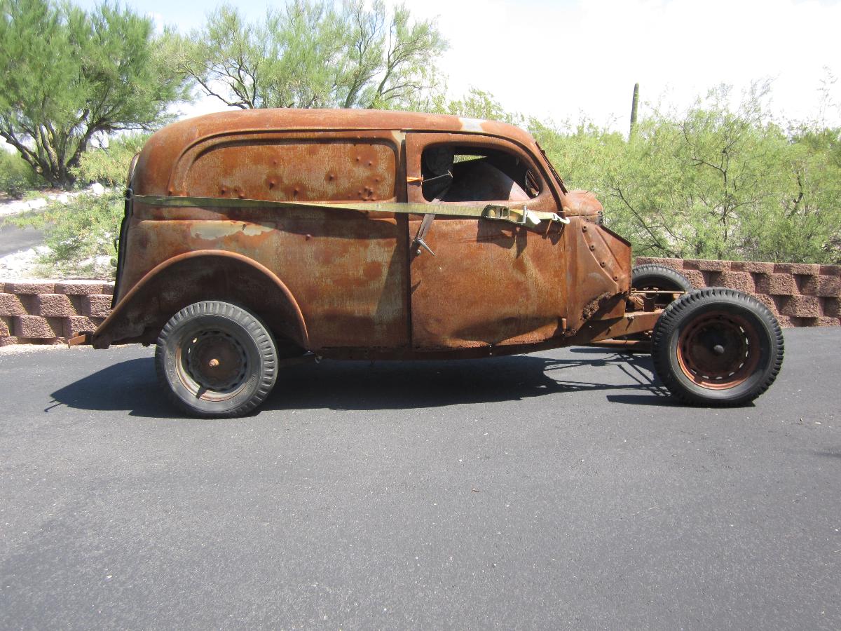

BTW, on my rust bucket 37 SD, my back door wood as rotted out too. I connected with a guy in Oregon who does wood repro for SDs. Not sure if he has done 36 SDs or not. Heck, the rear door may be identical to a 36??? They look very similar. Some of the interior wood surrounding my rear door was also rotted and he hooked me up with all that I needed. I can give you his info if interested.

Briggs,
The info I mentioned is from page 163 of "The Early Ford V8 AS HENRY BUILT IT" book. There is also a nice picture of the front seat area interior. It shows the black steering column and other details.

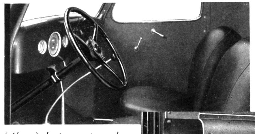

Don Rogers
09-27-2020 @ 4:49 AM
Posts: 512
Briggs, Here is an image from a 1936 Truck Dealer Album showing the Benton Grey Dash and black steering column and wheel.
