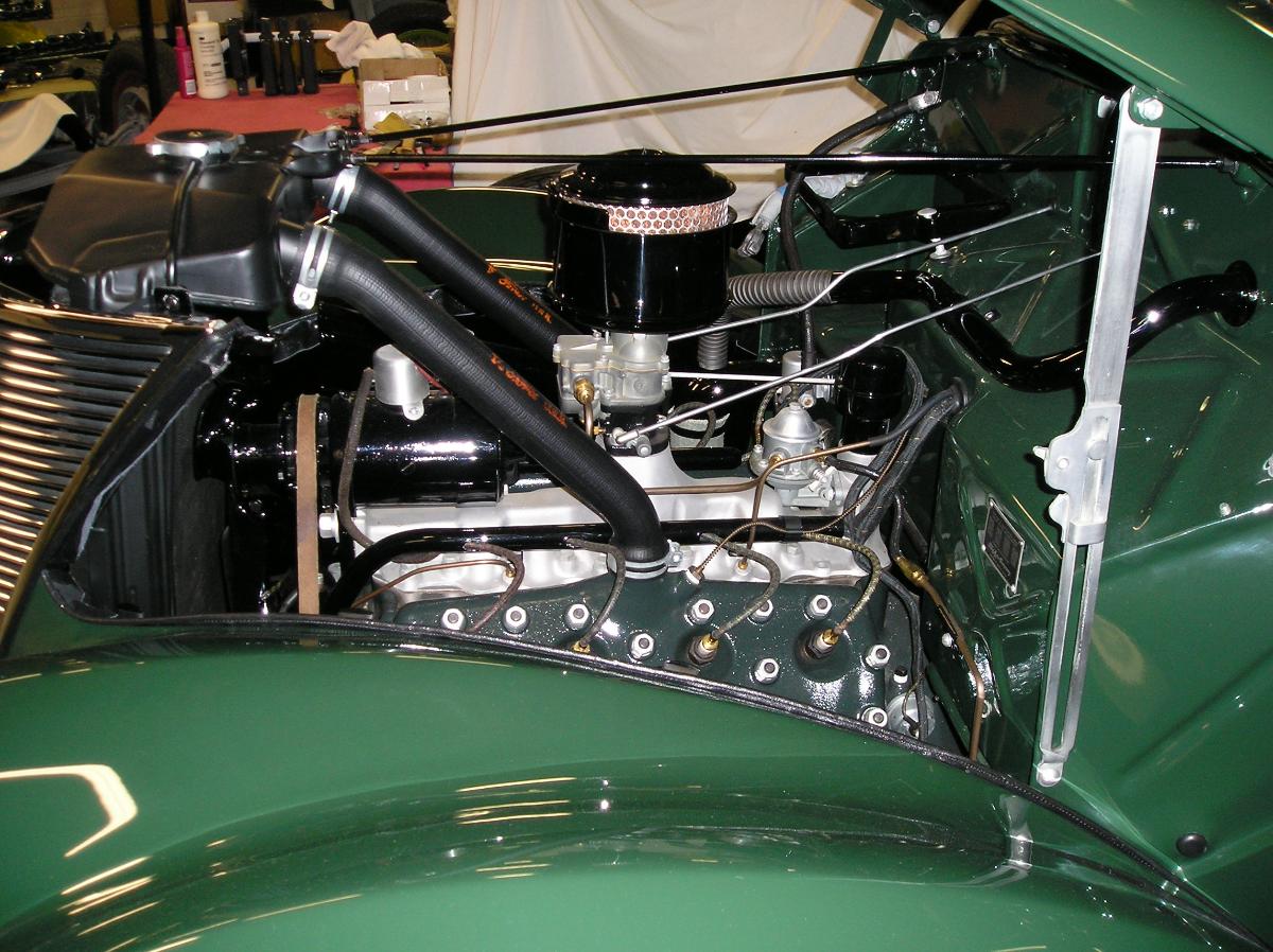

I recently acquired a 1937 business coupe which appears to have no means of keeping the hood open. I see catalogs which list hood springs for 39 and later models but nothing that applies to a 37. Surely not everyone uses a wooden stick like I do.

I use the stock hood support arrangement for my 37's. It works good, but be careful when closing the hood. When the hood is in an open (up) condition, don't just press down on it to close it. Rather, lift the hood a little to unlock the support mechanism and then gently let the hood down.

"Jay, congratulations! That is a beauty! The hood prop you seek, while correct for the car, was removed by the previous owner for good reason. While being an ingenious design, it was not right for the application, and caused most (yes, MOST) hoods to be severely damaged upon being closed without first ratcheting the hood prop...Alan"

1937sedandelivery,
Thanks for saving me the trouble of digging out that photo of my cabriolet's hood prop from my photo files.
