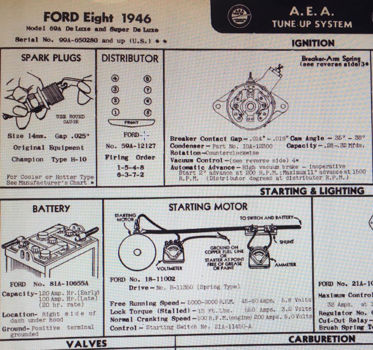

51woodie |
08-29-2020 @ 1:21 AM
Steve. I'm a bit puzzled with your post here. I have a '46 coupe with 59AB engine, and I don't know what you mean by "the dot on the pulley". Also, the tune up info that I have specs. .025" on the H10 plugs. Is .030-.032" a better setting?
GK1918 |
08-29-2020 @ 6:10 AM
Posts: 134
Joined: Aug 2016
correct, there is no dot on the pulley that dot started with the 8BA engines.

sarahcecelia |
08-29-2020 @ 12:46 PM
Posts: 1196
Joined: Mar 2013
Sorry about the "dot", I was thinking of a 1949 thru 1953 Flat head 8. You have the older flattie with the distributor is on the crank shaft! Flatties of the 50's take 28-32 thousands plug gap, and H10 Champions; and those specs are probably the same for yours. But run that car like I said; "Up to temp, and Highway fast,60-65 MPH, for 10-12 miles round trip!" Then stop and check that exhaust pipe for soot!! Regards, Steve Lee
