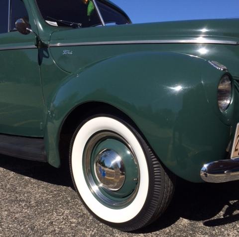

For what its worth, here is a pic of a DiamondBack Auburn on my '40. (different than your wide-five '37 wheel)
I opted to buy the radial tubes with them. I feared rim leaks with my old original wheels. I feared I would come to the garage after long storage to find a flat tire from a slow rim leak. And I feared could not just air it up, feared the flat tire would roll off the rim not designed to hold onto the bead of a tubeless tire. That would mean pulling the wheel/tire and a trip to a tire shop. PITA!
Have not had a single problem with the tires in three years. Love the vintage look of the pie-crust sidewall. I tell myself that compensates somewhat for the incorrect look of the radial tire bulge.

Looks awesome!!
How do they ride compared to Bias ply?
My biggest issue with Bias Ply is the way they like to "grab" the ruts in the road!
