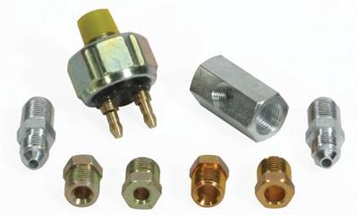

My guess is you have 2 issues. First is a ground problem and the second is the switch itself. The stock off the shelf switch I had in my '39 p/u didn't activate the brake lights until the brakes were fully applied. I purchased a low pressure switch from a supplier in Orange County, CA . I have the info down in my shop and I can post it later today. The low pressure switch allowed the brake lights to work when I just tapped the brakes as opposed to only coming on with full pedal. Others have used a switch from Harley Davidson as a replacement for leaking switches. Don't know if they are low pressure or not.

Did that low pressure brake switch have the correct bullet connectors? If so, I would like to hear where you got it.
I replaced my brake switch with a Harley Davidson part because it does come on with less pressure. But I had to create a wire transition pieces to go from the original bullet connectors to the modern spade terminals on the HD switch.

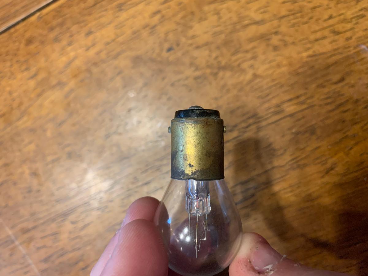

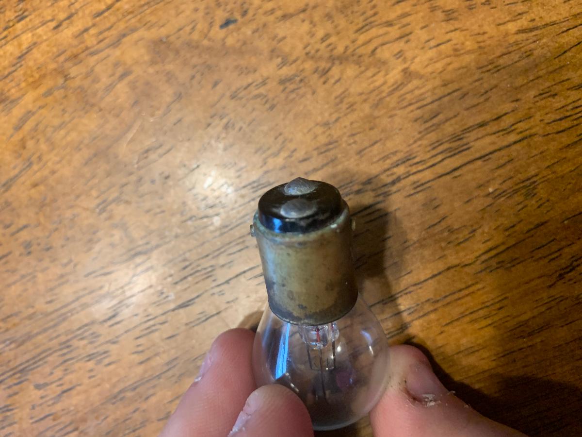

On a side note does anyone know what the bulb number is for the front parking lights? I know tail are 1154. Similar but slightly different side nubs.

1057 12 volt single element 1129 6 volt single element if my memory is correct.

CPP Classic Performance Products
www.classicperform.com
800-522-5004
Part number CPP-LBPS
yes has the same bullet connectors as a stock switch

In regards to the bulbs. Looks like both of those are a single connection point. Mine is a double? I also checked cup and they had no price on the brake switch. I’ll call them during the week
