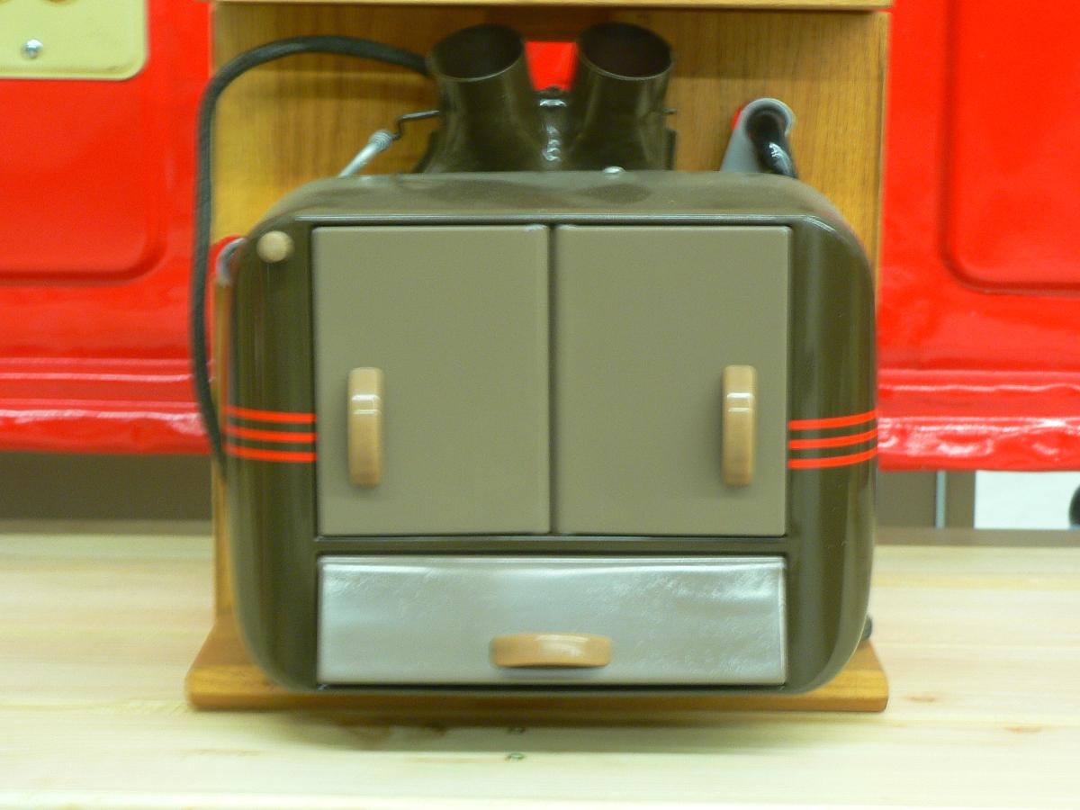

I drove my car for many years without a heater, and was comfortable down to the 40's on sunny days. If it was cloudy, 50 was the lowest that I could be comfortable driving the car. My wife and kids had other ideas. After I installed the heater tha car became more enjoyable to drive in all weather. On hot days, I can turn on the heater blower to help cool the coolant, on high humidity days, the defrosters keep the windshield clear and on cold days it keeps my feet warm.
If you can find a nice 41-42 heater, I would install it. It is a much appreciated accessory.
Here is a photo of a 1941 -42 Ford heater at the Early Ford V-8 Foundation Museum in Auburn, IN.
