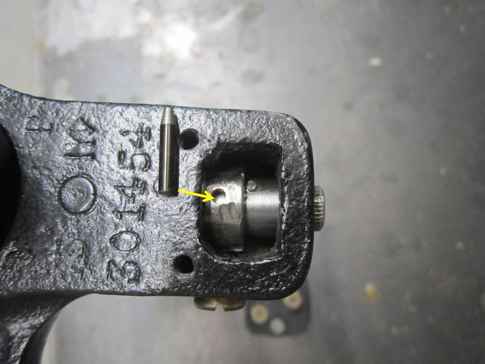

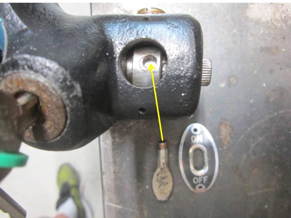

Hello,
I am rebuilding my 37 column drop. It is all back together except for the pin that actuates the ignition switch contacts and the on/off lever itself.
Are both of these press fit? I should locate each item slightly above its respective hole and lightly tap into place? I tried this with the on/off lever and it didn't want to readily seat in the hole. I should apply more force?
Last thing i want to do is bugger something up.
Thanks,
gregg
06-21-2020 @ 9:40 AM
Gregg
as far as I can remember is should fit together,with no problems, ignition switch is held together with screws,with 2 studs sticking out the back for attaching the wires, I do not remember using force to assembly the switch, just a little tricky
if you are using reproduction parts I think that is the problem,
if you could post a photo it might help
my 2 cents 37Ragtopman

Two jpeg photos attached
06-22-2020 @ 5:55 AM
hi 37Sedandelivery
I thought you were talking about the electric switch part, not the switch lever and operating pin being loose or stripped out,
I guess you have to use a little force pressing together
looks like you are missing the chrome end cap,
after studying the photo, looks like you need to disassemble the whole switch to correctly install the parts you have,
this may be the easiest way, so what you put together does not come apart,
do you have a spare switch for parts.?
maybe someone else has a better answer,
hope this helps 37Ragtopman
