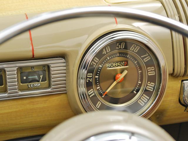

It sound like you might have a problem with the 900 mile wheel. Did you check for speedometer repair in Ontario? I found this when I did a search.

Picture of '46 Ford Speedometer....

05-23-2020 @ 1:25 PM
hi 46 ODOMETER
I assume this is a original FORD SPEDOMETER,
driving in reverse will not subtract the millage , it is magnetic drive it only works in one direction,
there is probably one of the gears inside that are not touching, or meshing correctly. loose screw ??
you can use a drill [ at low speed,] when the speedometer is out and watch what is happening,
might be a easy fix, these are very fragile so be care full when handling,
hope this helps, 37Ragtopman
maybe Bing or Google a few videos on repairs of speedometer ?

05-23-2020 @ 7:55 AM
fen. I can try backwards to see if it unwinds.
alan. There is no trip meter in this unit
