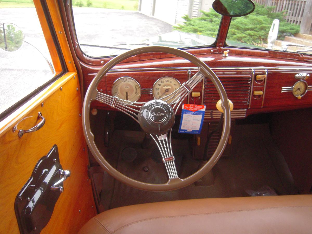

Looking for a current paint code for the steering wheel, column drop, column, horn button etc. for 39 DeLuxe. Thanks for any help

The Deluxe Steering Wheel hub, Column, and Horn Button were painted Zephyr Beige. The Deluxe steering wheel rim was painted Cameo Gray. This info. is from "The 1838-39 Ford Book" published by the club. Hope this helps.

I have the lighter (Zephyr Beige) of the two formulas in Centari. Did a couple '39 deluxe cars with it. Both did 999 so I believe you can be reasonably confident I did my homework.
Quart:
758S Drier, 46.5
717A Red oxide, 130.2
732A Fer yellow, 286.6
700A White, 614.4
705A Black, 944.4
Started with Spectramaster yellow, YS235

Kube, Your wagon is very nice. Thank you for the paint information.
