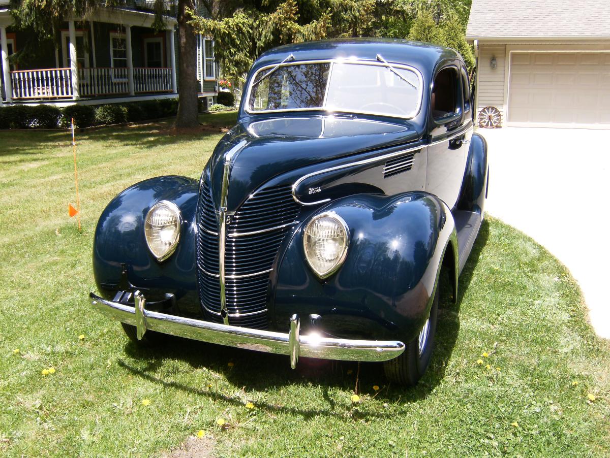

Although (seemingly) nearly all '39 standards on the concourse have the recessed area of the hood ornament painted the so called "Ford Blue" they are absolutely incorrect.
The only ones that were painted that color were service parts.
Off the assembly line, the recess was painted to match body color.
The photo attached is one of the standard coupes I'd restored. This one did 999 both times out. You can, I believe, easily see why it even makes sense to match the body color.
