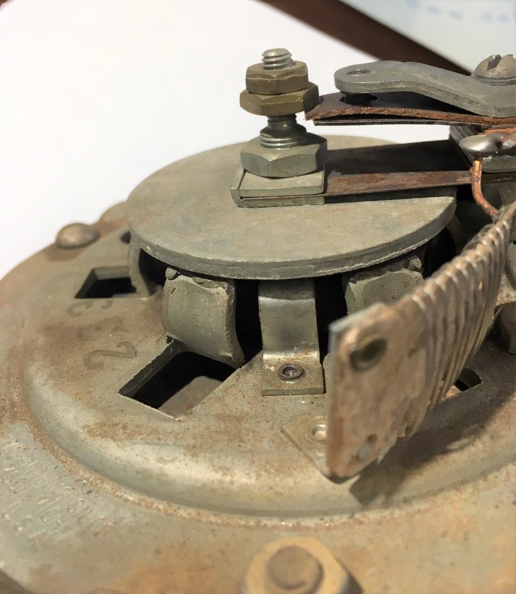

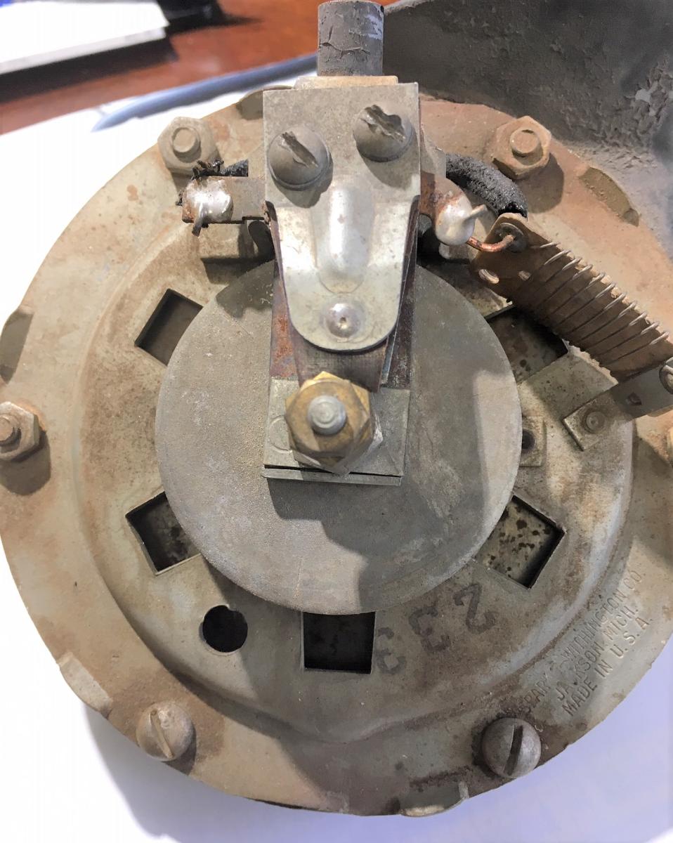

Gordon. I don't know if the '51 horn is the same as or similar to the ones on my '46, but as I recall, (I'm old, and did the job a few years ago), the cover just snaps on to the body. I attached pics of what mine looks like inside. The problem was that one of the two horns was not working. It checked okay with the ohmmeter, so I cleaned the contacts with 1000 grit wet/dry paper and that fixed it. Hope this helps.
