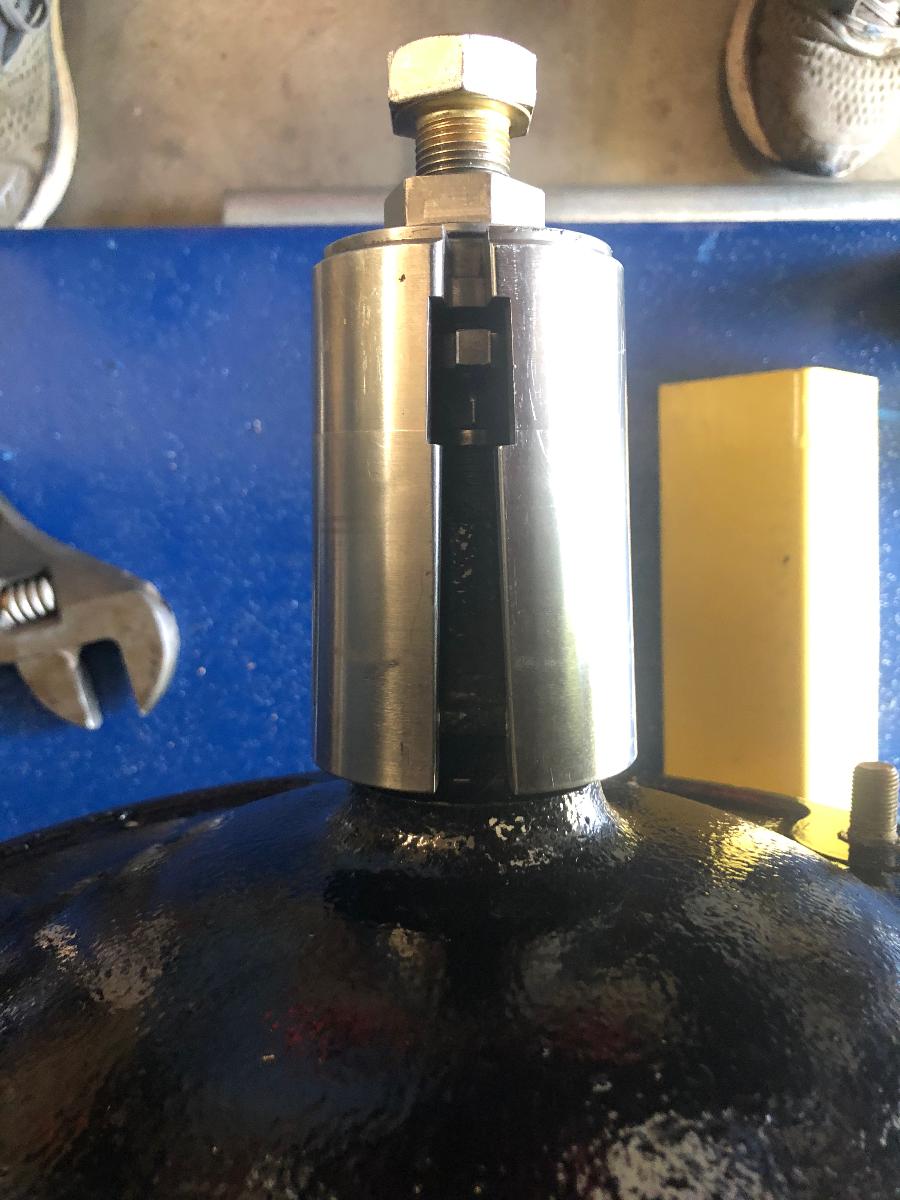

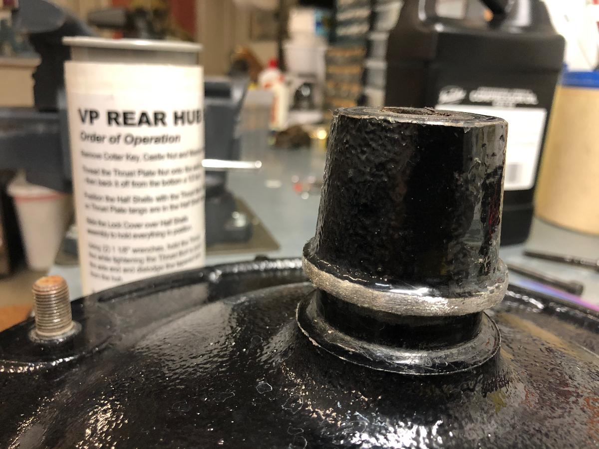

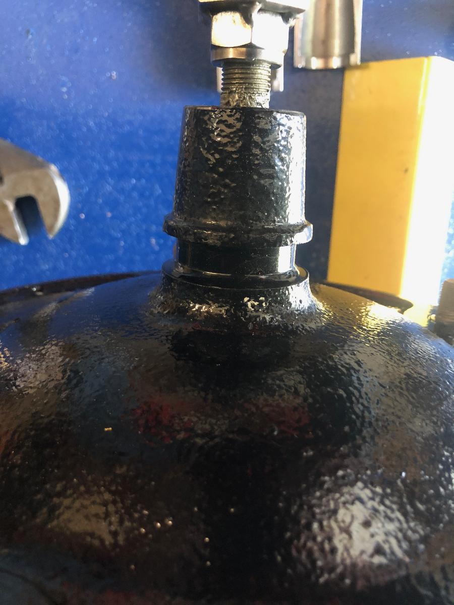

Thanks for all the helpful suggestions guys. After no success with the three-pronged drum puller I resorted back to making my VP ABV-156 hub puller work. I called them yesterday and they were very helpful. They said there have been a few instances where their hub puller just didn't quite fit correctly. So I took their suggestions and just filed down the offending lip on both hubs that was preventing the hub puller from closing all the way like it should. Once the puller fit correctly it was surprising how easily it popped the drum off the axle. Definitely the "cat's meow" when it comes to early Ford brake drum removal. Attached pictures show my drum before grinding, how the puller was not fitting properly and then how the drum looked after some minor grinding on the lip. Thanks again for all the suggestions! Highly recommend the tool!
