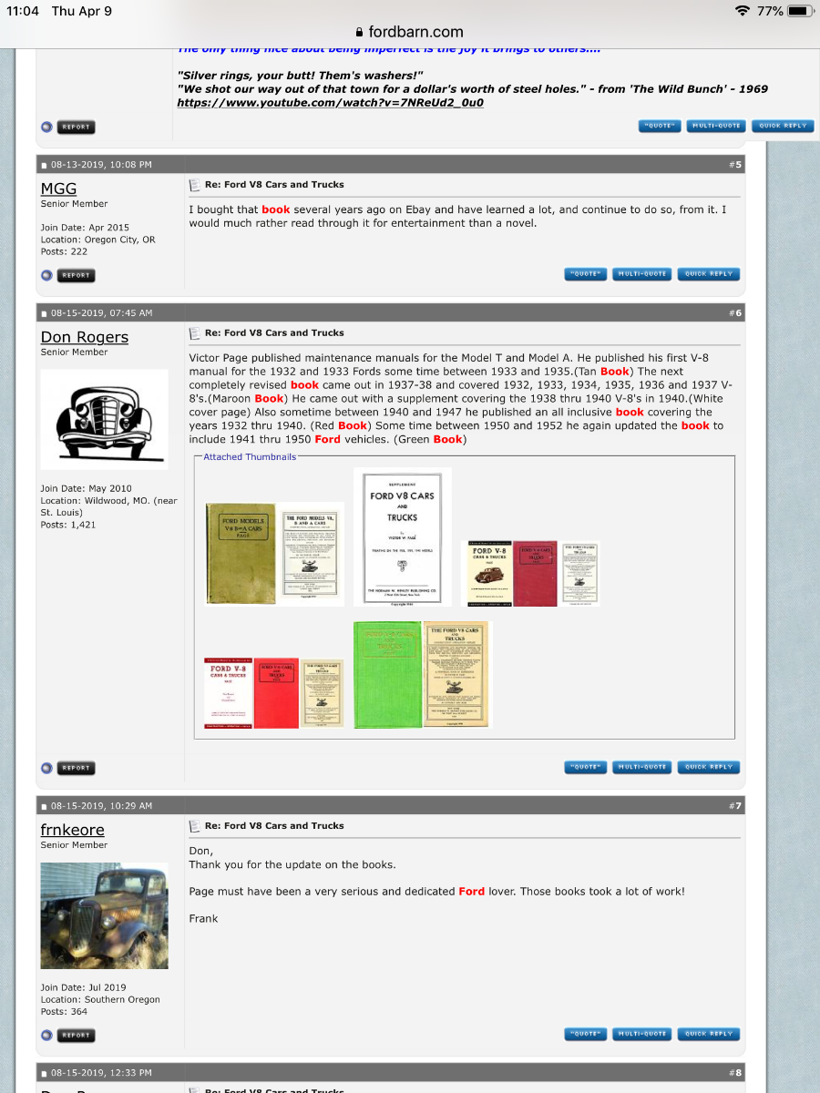

In the event some else travels down this trail I found a post by Don Rogers citing the books by Victor Page. FORD V8 CARS AND TRUCKS was listed. Found a 1947 copy on the Internet for 20 bucks. It covers from 32-40. Lots of great information.
Way more info than the service bulletins, presumably taken from Ford’s service manuals.
