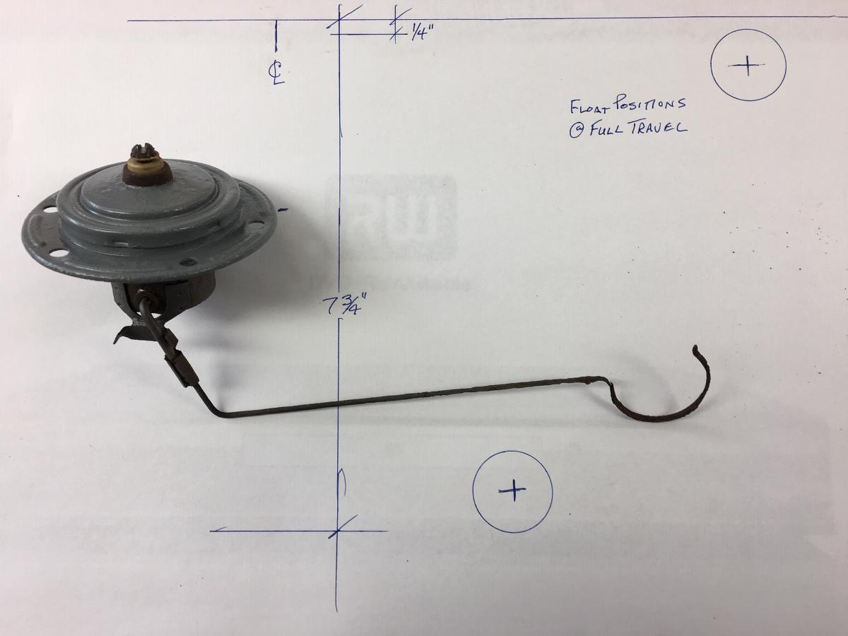

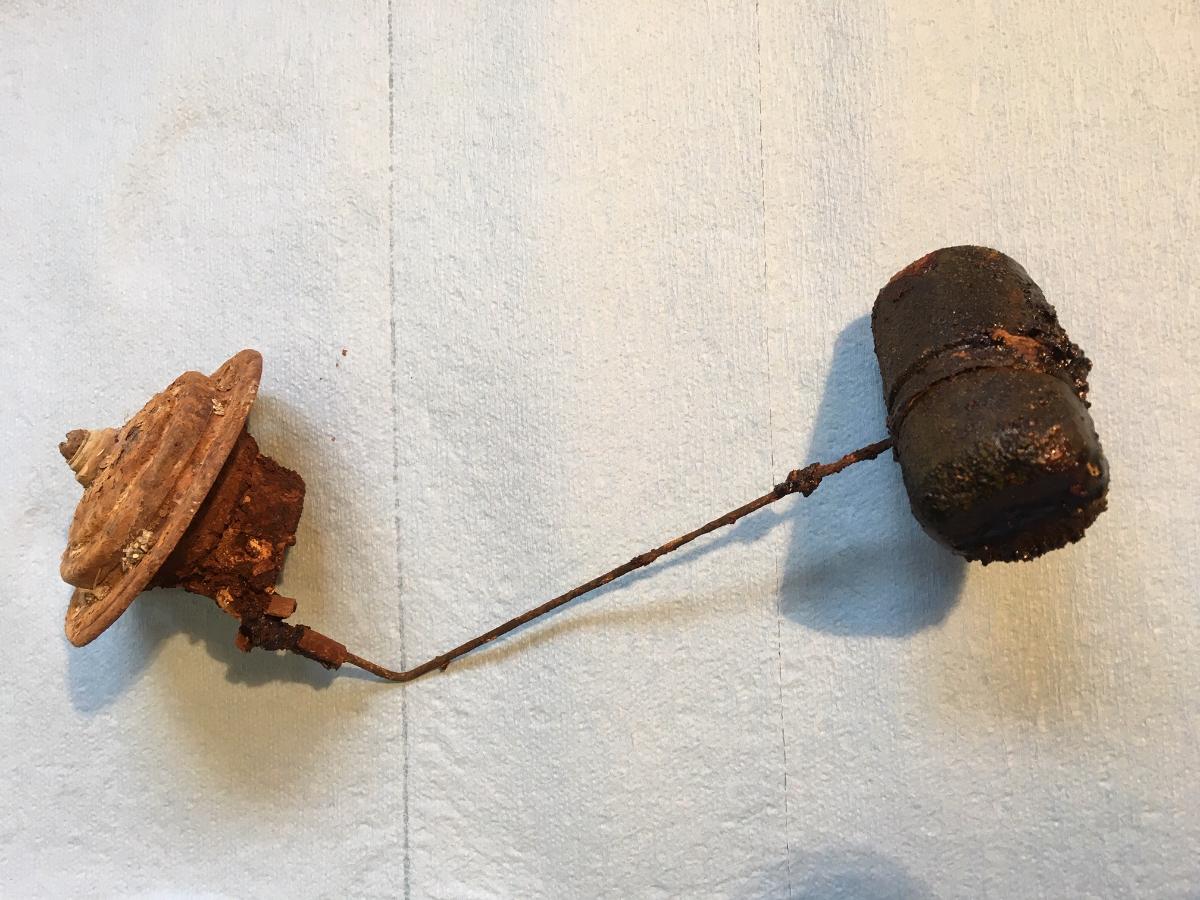

I salvaged a King-Sealy fuel sender from a 51 Ford Wagon, and the sender works when tested on my dash gauge. The problem is the wire from the sending unit to the float is almost corroded away, so I need to replace the wire. Also, I don't know the correct length or profile of the float wire that would be used in a 46 tank, as the existing one is an aftermarket unit made in Brazil. Does anyone have a picture or measurements/drawings that would help with preparing this unit for use?

From the pivot point to the bend is 2 1/8" and from the 90 degree bend to the float bend is 4 1/2 ".

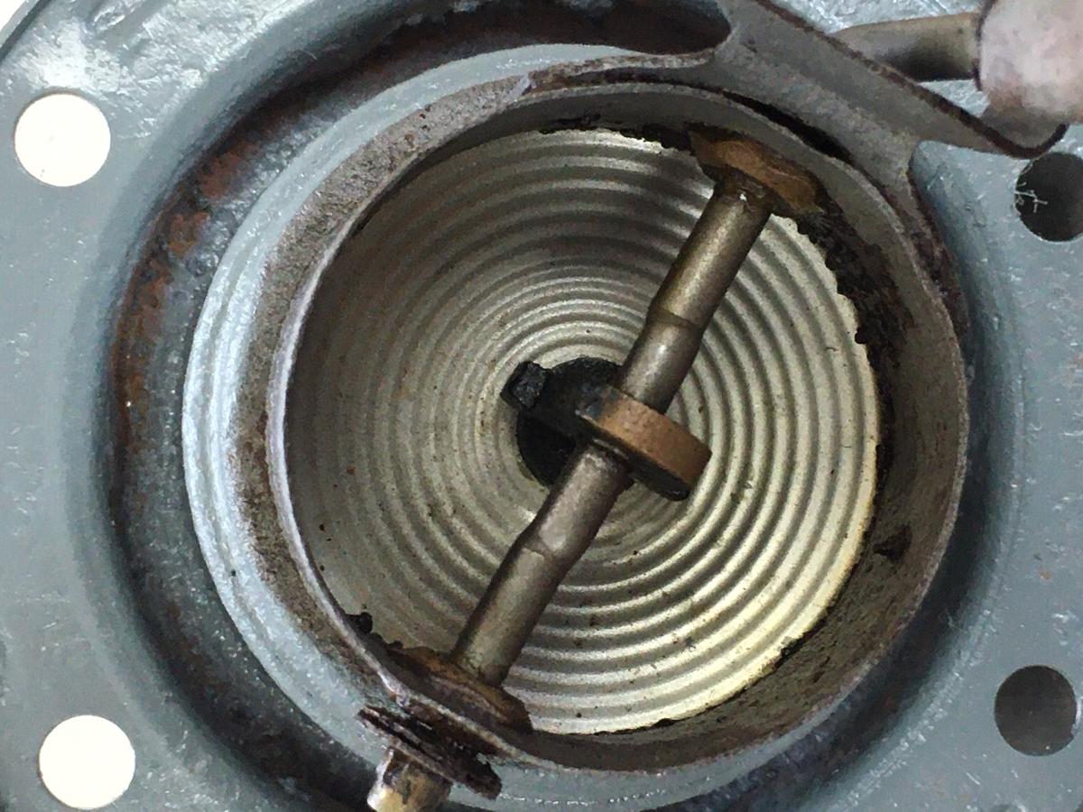

The photo that you posted has the correct profile. Check the diaphragm to make sure that it is not rusted through.

Hi Tom. Thank you for the info. The measurements on my sender are 2" and 5 3/4". As to the diaphragm, it was covered with scum which I removed with walnut sh*ll blasting. On your prompt, I will remove the cover, support the sender inverted and put a bit of fluid on the diaphragm to see if it leaks through. I sketched the range of travel as exists, and later, will draw the range based on you measurements to see what the vertical travel would be. I think the important thing is the float does not hit the top or bottom of the tank when full or empty, as that would cause damage to the float.

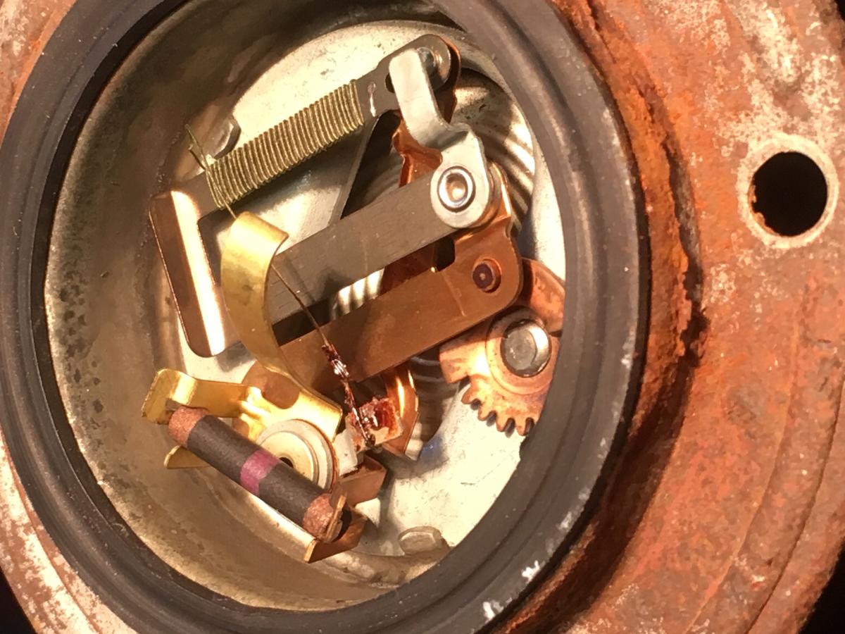

trjford8. The sender that was in the car when I bought it was not an original KS sender, but aftermarket. Another question that came up as I was checking/cleaning the sender from the 51 is, what the gear shaped piece (see picture) is for inside the sender. My logic, which my wife often questions, is that it must be for calibrating the sender. Does anyone know? If so, how were/are the senders calibrated.

That is for calibrating the sending unit. I do not have instructions for calibration and you probably do not need to calibrate your unit. Fuel sending units are just used to give you an idea of the amount of fuel in the tank. They will show full even though you have used a gallon or more of fuel and will show empty when you have a gallon or more left. The other readings range between those two readings.

You can use the rod on the after market unit if it is long enough and you don't want to save the unit or bend your own out of steel rod using the rusted one for a pattern. You do not need to solder the rod to the unit, just pry open the union and use it or a new one. You can buy side by side unions on Amazon.
