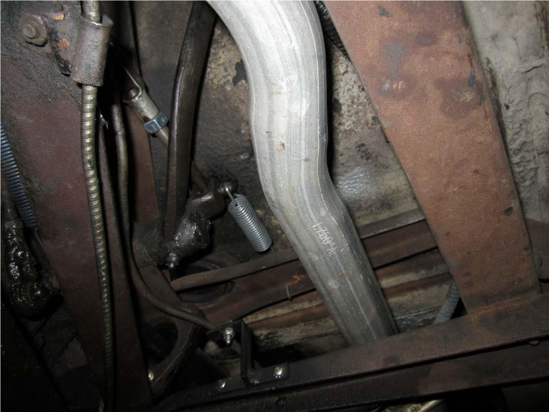

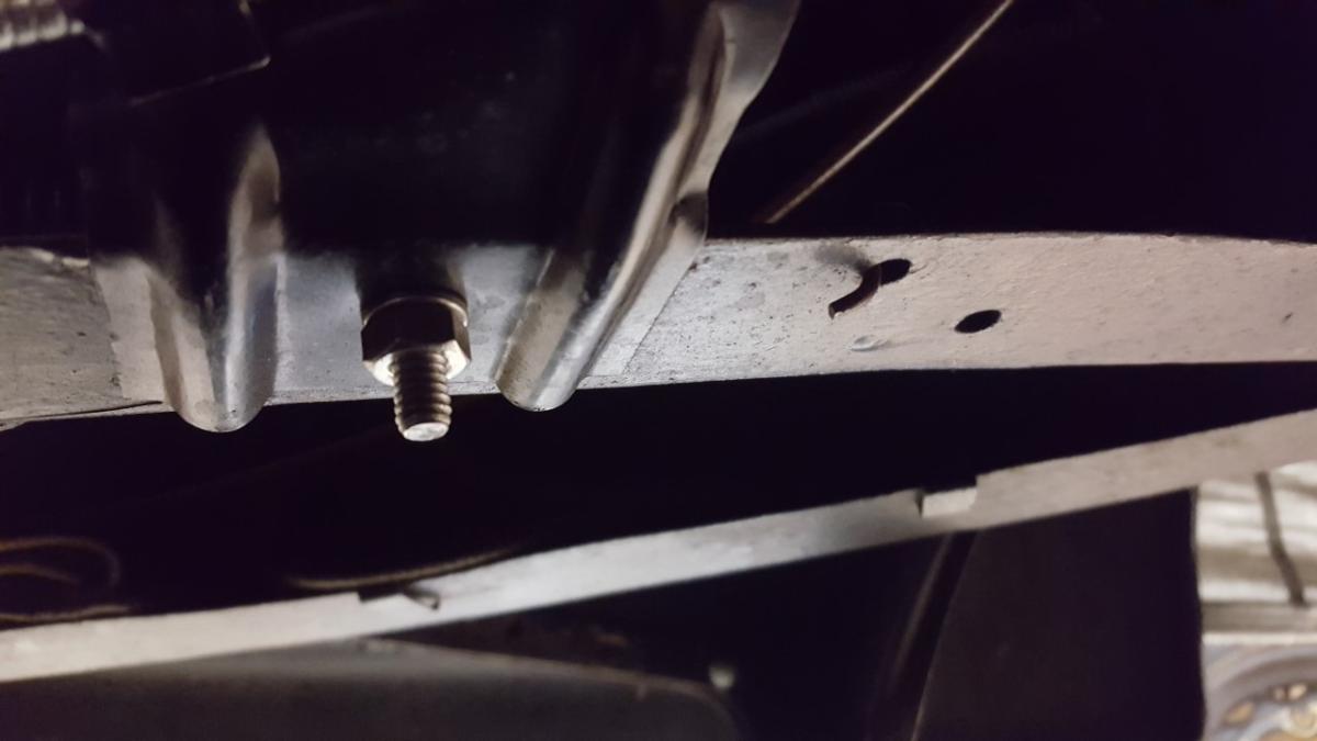

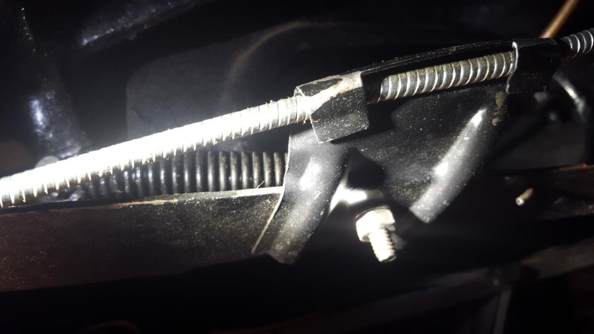

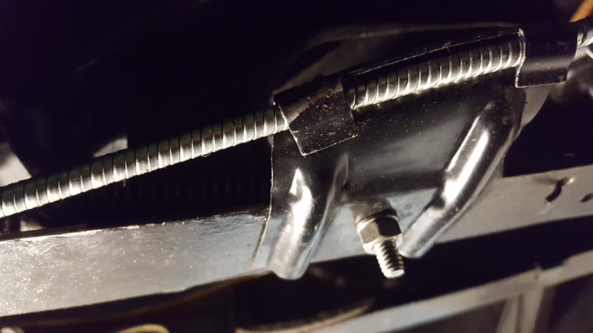

Not sure these will help. This is the arrangement for my 1939 Deluxe.
Larry
