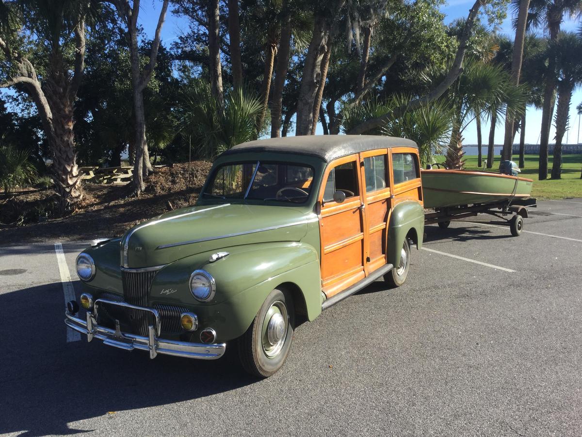

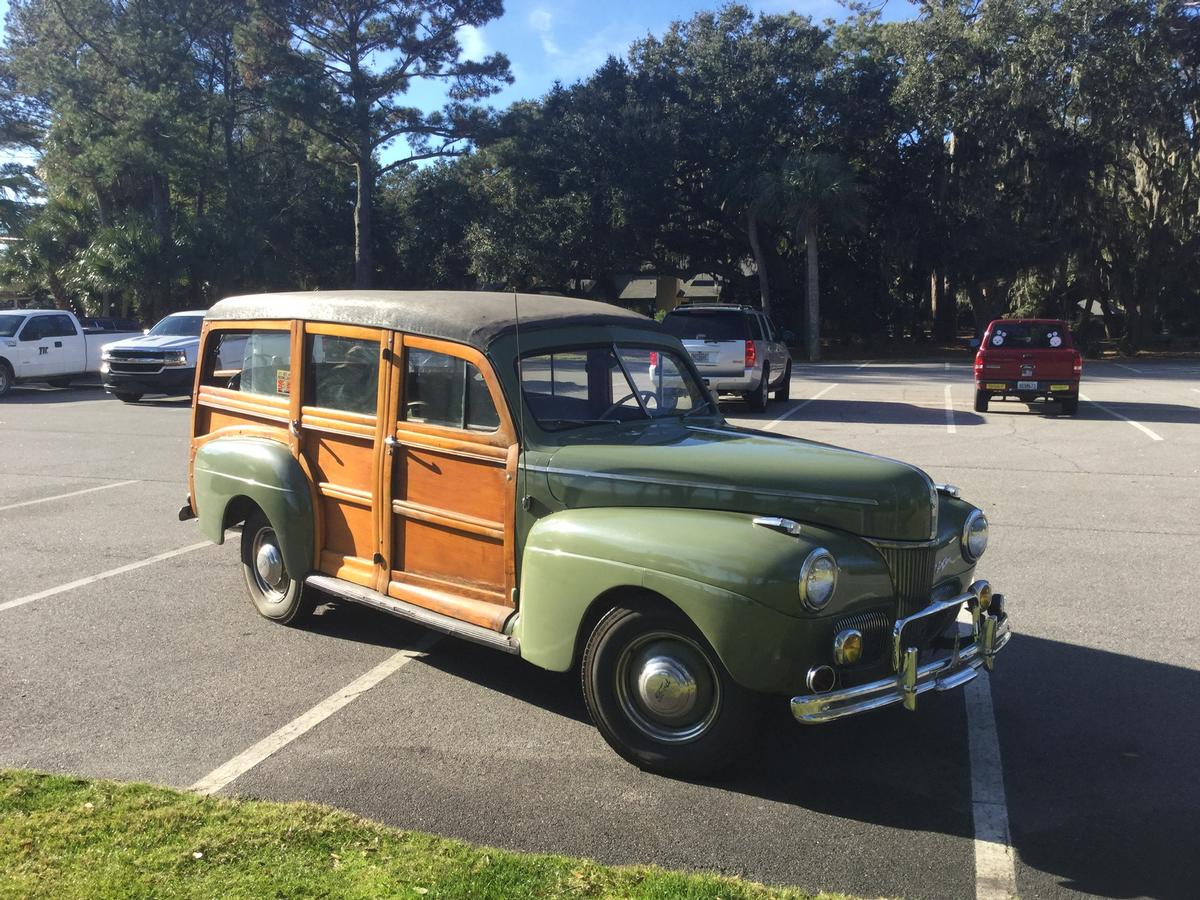

OK, I updated my information. This morning is the first time I have used this forum, and this vehicle is the first early V8 that I have had in a very long time.
My 41 is essentially stock with the exception of a stock dressed 8BA
The Patent Plate example I saw would verify paint color. My car is Lochaven Green.

Disclaimer, I am into '32 Fords although I did own a '37 for a while. I doubt any plate would show body color but you should get a copy of the book that covers the '41. Go to: https://shop.efv8.org/collections/ford-books/products/1941-1948-ford-book-softbound The book is now a "how to" but rather how it should be. Bob Drake has key blanks (https://www.bobdrake.com/FordItem.aspx?Item=91A-3685) but I assume most vendors sell them. You might be able to combine them with other parts you are buying to save shipping. How about a photo of the car?

According to the 41 to 48 Ford book Lochaven Green is a proper color for your vehicle.
