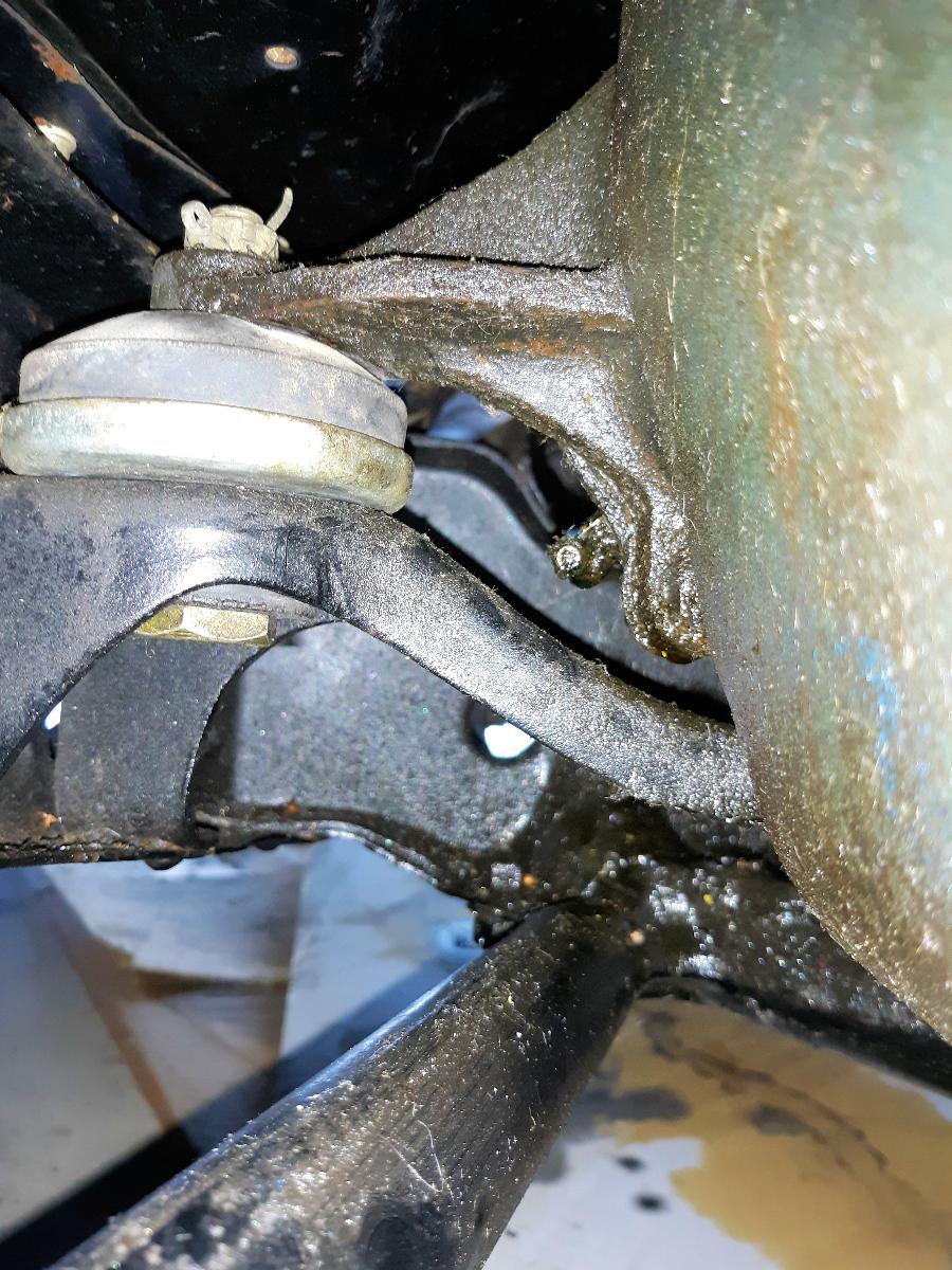

It sounds like you found your problem. Those bushings should not be free. See: https://www.earlyfordv8.org/forum/viewmessages.cfm?Forum=18&Topic=10525&keywords=chatter

Hi there again.
I wrote in February about my 1939 Deluxe clutch shuddering in reverse and when taking off in first gear. I haven't had the car out a lot with all of the COVID shutdowns, etc. The consensus here was to check the motor and transmission mounts and replace them. So I did check them and some questions arose.
As I mentioned before I replaced the front motor mounts as part of a water pump upgrade last year. I've had a good look at the rear mounts and took a picture of one of them. The motor mounts actually look solid to me as far as the rubber goes. I attached a picture of it for you to look at. Here are some more questions.
1) There is a large rubber bushing that is between the head of the brass colored bolt underneath the frame. The rubber bushing under the bolt head between the bolt head and the frame is quite loose under there. I can move it around with my fingers. There doesn't appear to be any way to tighten it further. Is that normal?
2) Are there separate transmission mounts I should be checking and replacing? I'm not seeing anything obvious.
3) If you think I should replace these rear mounts anyways, what is the proper procedure for that? Sorry for all of the questions, but I tried to order a shop manual someone had suggested from Mac's but it has been out of stock since February so I'm sort of flying blind on this one.
Thanks for your input!
