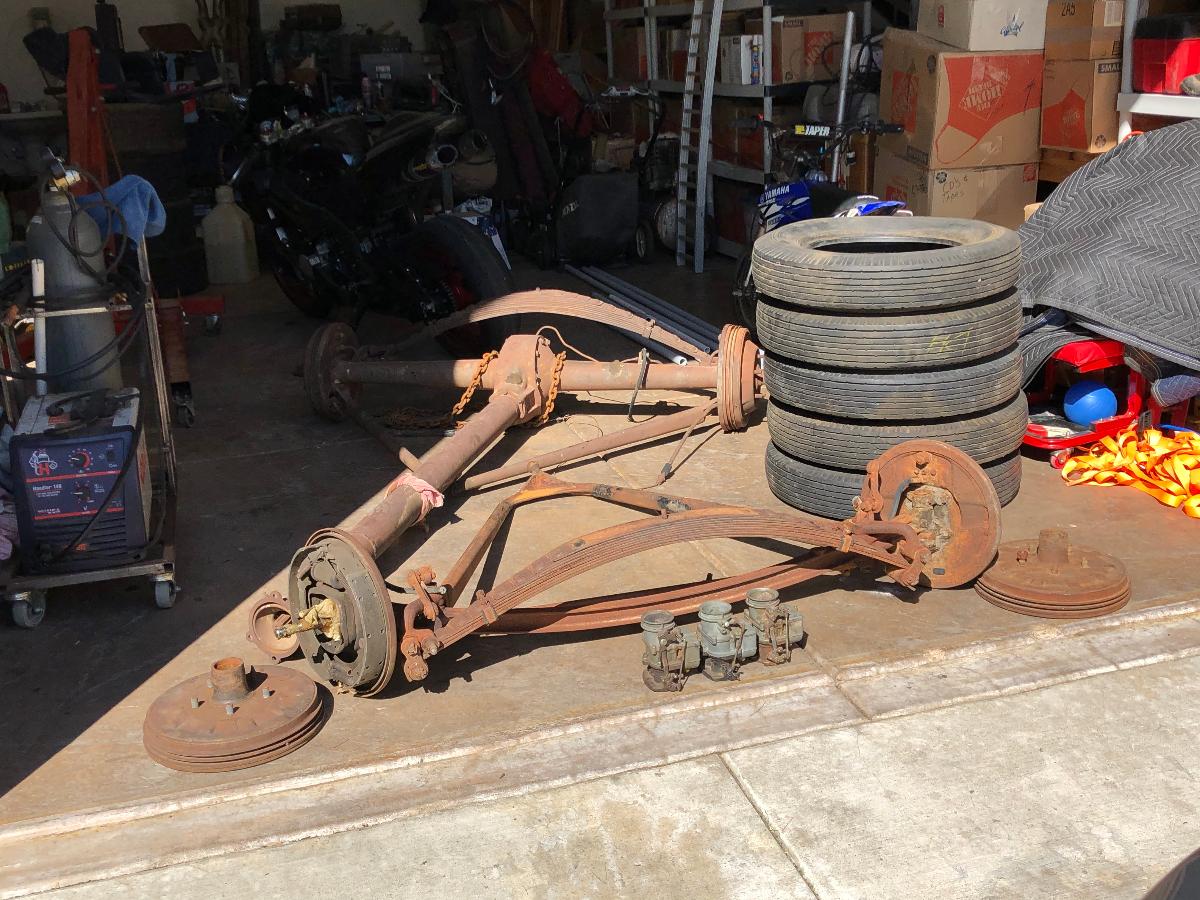

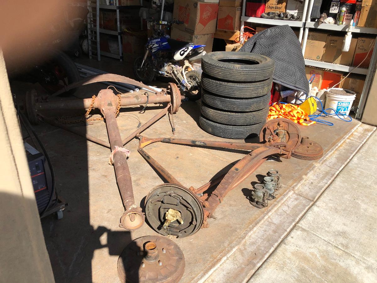

Can anyone tell me if the front end and rear end parts are the same in the 1941 Lincoln Zephyr and a 41 Ford. If not what are the differences. Thanks for your time.

Differences? Pretty much everything.

A quick glance at the parts catalog found the tie rod and ends and a couple of nuts are the same for the front end. I did not check the rear end parts, but I believe that some of the bearings, seals and nuts are the same.
If you are trying to fit a Zephyr front end and rear end on a 41 Ford, I would start the search over and find the Ford parts.
If you are trying to use Ford parts in a Zephyr, again I would caution against it, because the Ford parts are not designed to take the stresses in a Lincoln.
