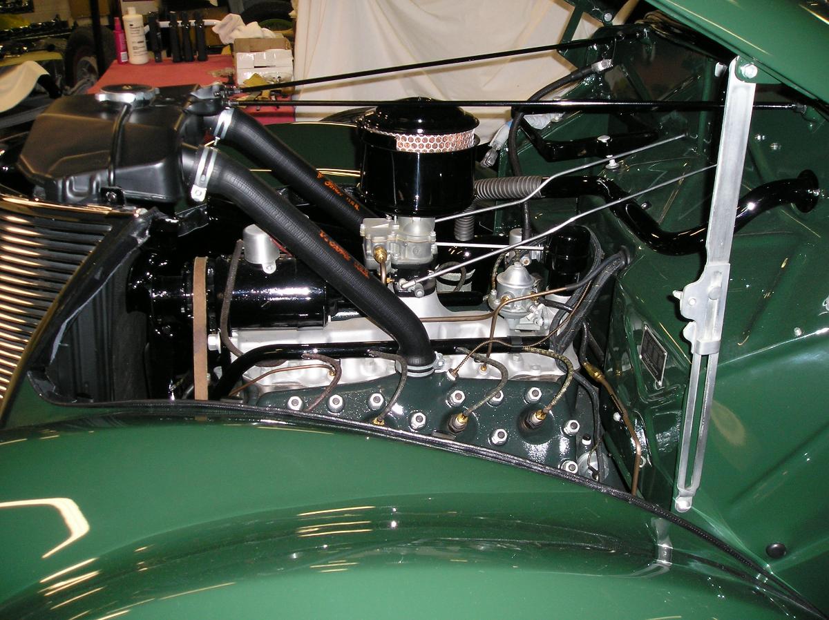

Can anyone send a picture of the hood support positions when the hood is open--I can not see where it attached...thank you.
1937sedandelivery |

Not sure if this is what you are looking for. I can do/send more pics if you want. gregg
37fordguy |
02-10-2020 @ 11:01 PM
Posts: 25
Joined: Feb 2020
This is great thank you--you car is exquisite.

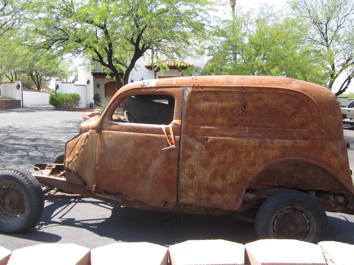

1937sedandelivery |
02-11-2020 @ 7:14 AM
Posts: 501
Joined: Jul 2014
The car in the picture in my original post is not mine. I ran across it a couple years ago and saved it. Here is a pic of my current 37 project. It goes verrrrrrrrry slow and needs lottttttttts of work. Gregg

JayChicago |
02-11-2020 @ 6:48 PM
Posts: 555
Re hood prop: There is some risk to having the hood prop on a '37 or '38. Prop supports hood close to hinge, with about 3/4 of hood cantilevered out beyond the prop. Hood can get bent. I chose to leave the prop off my '37. See this earlier discussion: https://www.earlyfordv8.org/forum/viewmessages.cfm?forum=18&topic=12441
