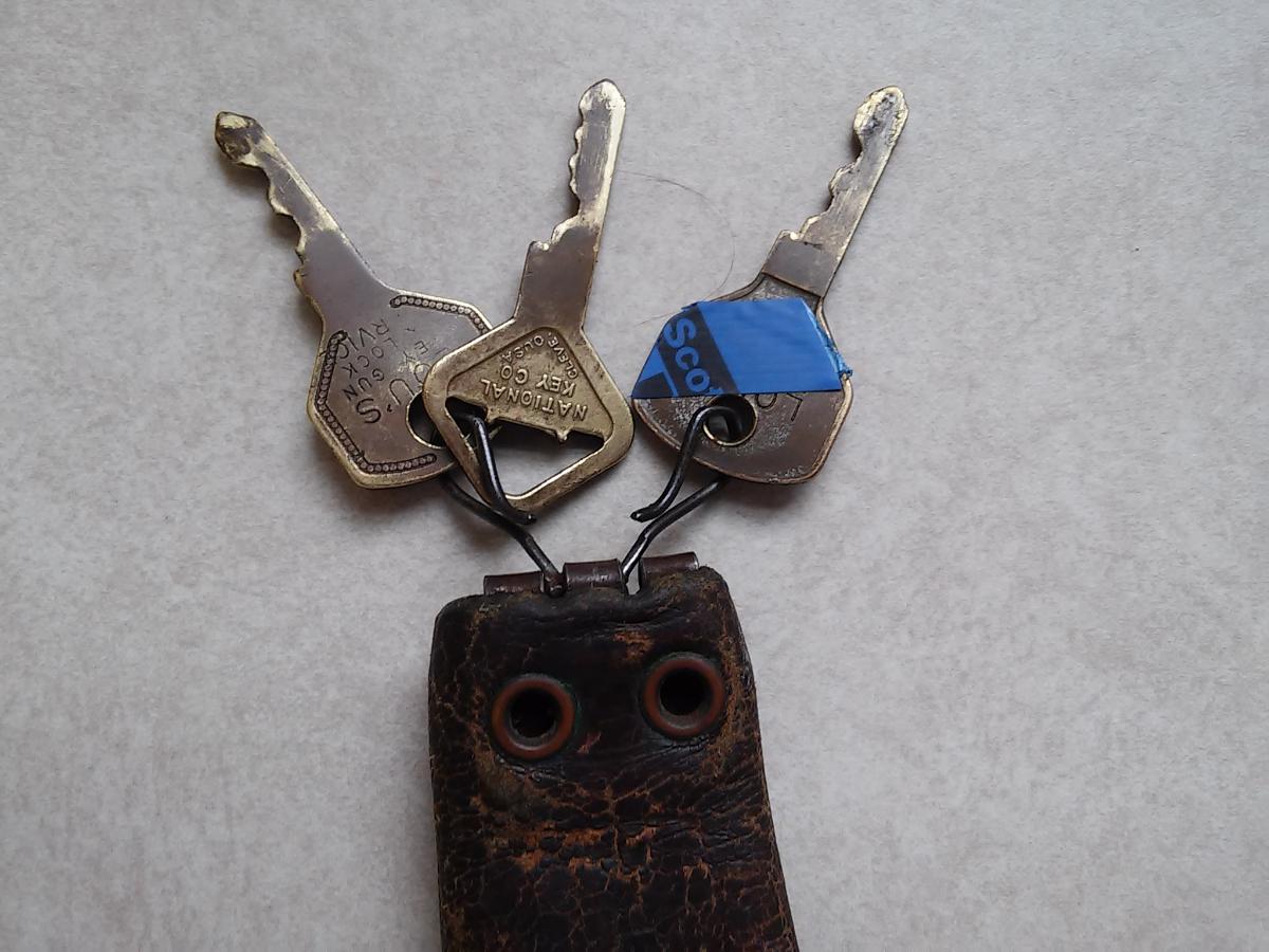

My 36 Humpback has 3 keys. Ignition, door & trunk. I had to WD40 all the locks and with the key installed work them back & forth until them loosened.
