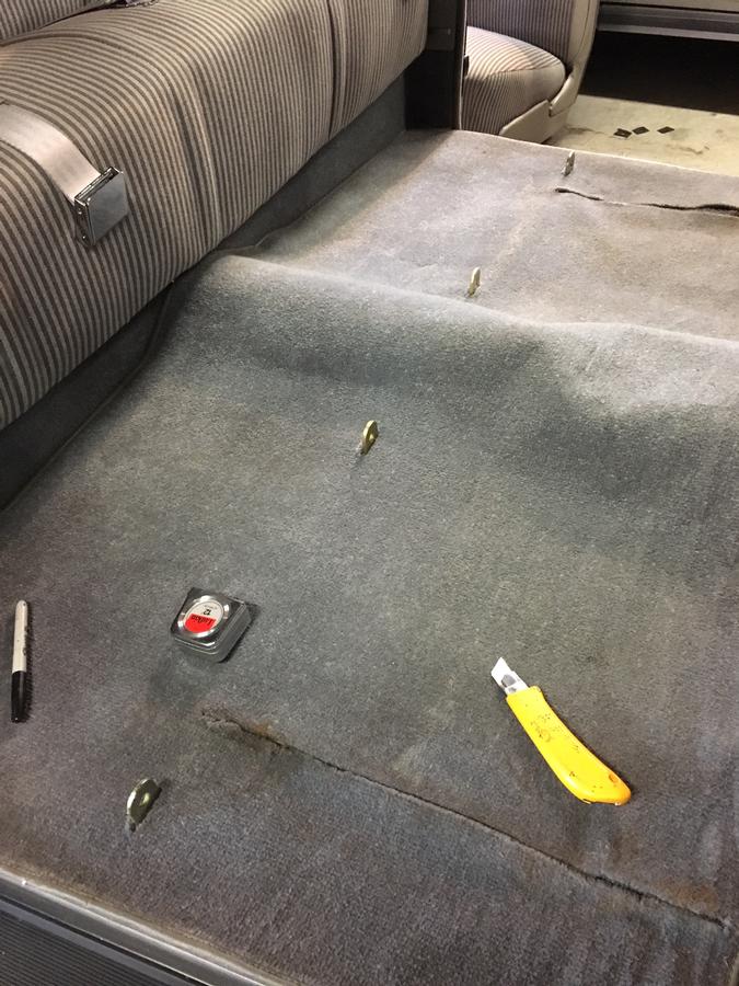

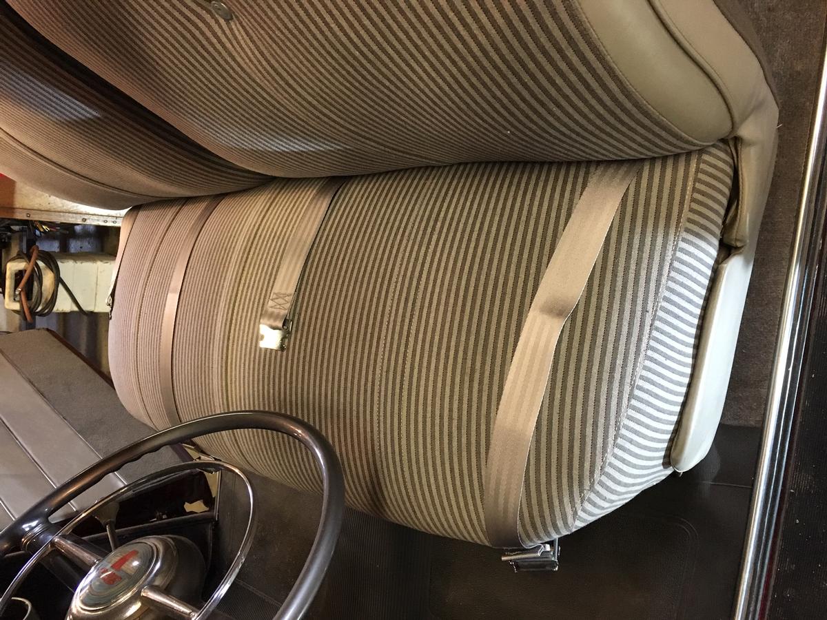

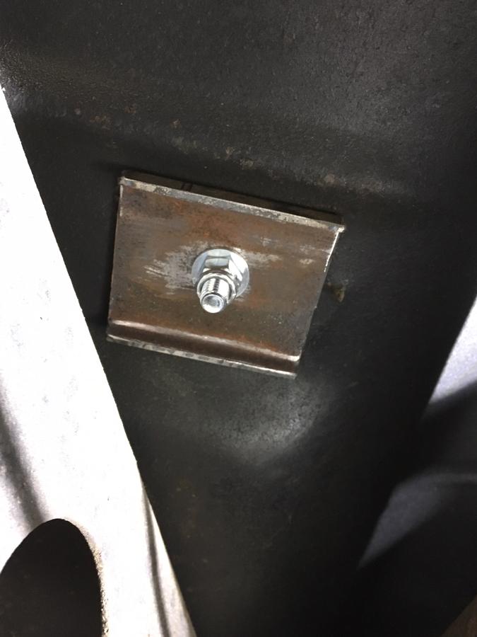

I got my belts from Seatbelts Plus for my '46 Coupe and was pleased with the belts I bought. As far as attaching, I went through to floor pans at locations that matched up with the back edge of the seats. You can buy mounting kits, but I only bought the 90 degree bracket to connect the belt to the floor. I used Gr5 bolts with locking nuts to fasten the 90 deg. brackets to the pan, as well as 1/8"x3x3 "backer" plates on the bottom side of the floor pan. Seatbelts Plus shows a diagram on how to measure the belts for the proper length. Still not sure why pics get turned 90 deg. when posting.

I found the really tricky part on my 35 Fordor was getting the front belts from the floor up through the bottom pan of the seat to come between the seat bottom and back. I had to slot the bottom metal pan which I hated to do, and screw in an undersized Delrin block that the belts come through so they don't rub the hole in the metal seat bottom.
I used Julioano's lap belt setup with the under floor plates but might be switching to their shoulder harness setup this summer even if it's not advertised for Fordor's.

Al, If you look at the middle picture of my post, you will see that by using the 90 deg. mounting brackets, you only need to cut a slit in the carpet, then push the carpet down over the bracket. So no holes to drill in the carpet. I installed the brackets, installed the carpet, then felt the position of the "lumps" where the brackets were and used and OLFA knife (in picture) to cut the slot just long enough to fit over the bracket. Done deal and nice fit.
