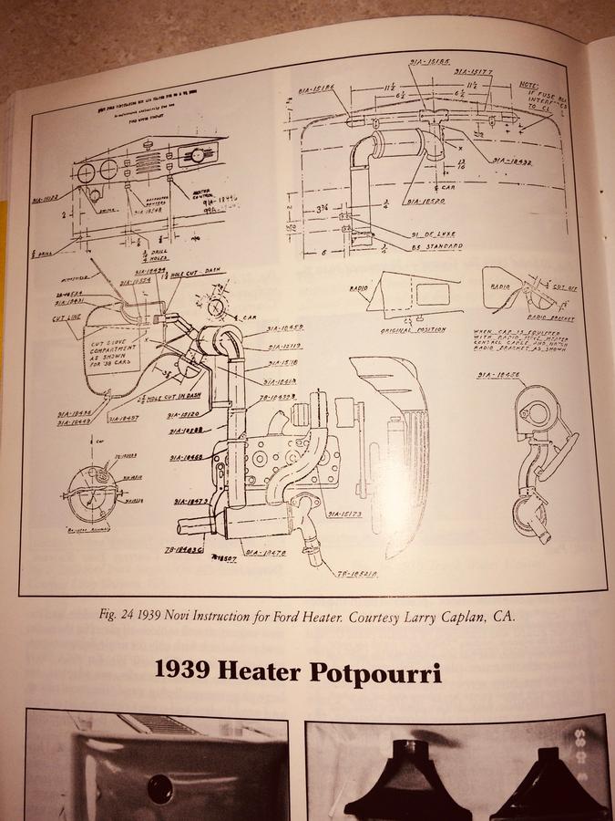

See attached photo from a 1989 V8 Times.

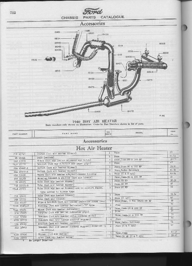

Here is a drawing from the Green Book. The air is sucked into the heater from the collector at the radiator by the blower, goes past the heat exchanger on the exhaust pipe, up into the passenger compartment and is diffused by the nozzle or directed to the defrosters.
