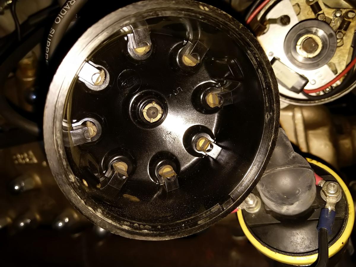

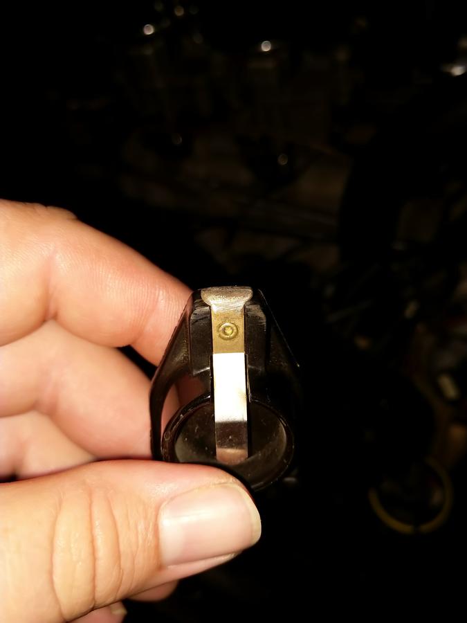

Had a quick look in the distributor tonight after kids were finally in bed. Cap does have something on the contacts where the rotor passes by. Doesn't look like corrosion, but I'd say more likely to be arc damage. Rotor contact has it too, and looks like previous owner has rather ham-fistedly cleaned the rotor already at least once. Could be the rotor-cap gap is too big. Distributor issues can be intermittent I don't have overdrive, unfortunately. Vacuum advance was going to be my next suspect. If things are a bit wonky, the shoe might fit.
