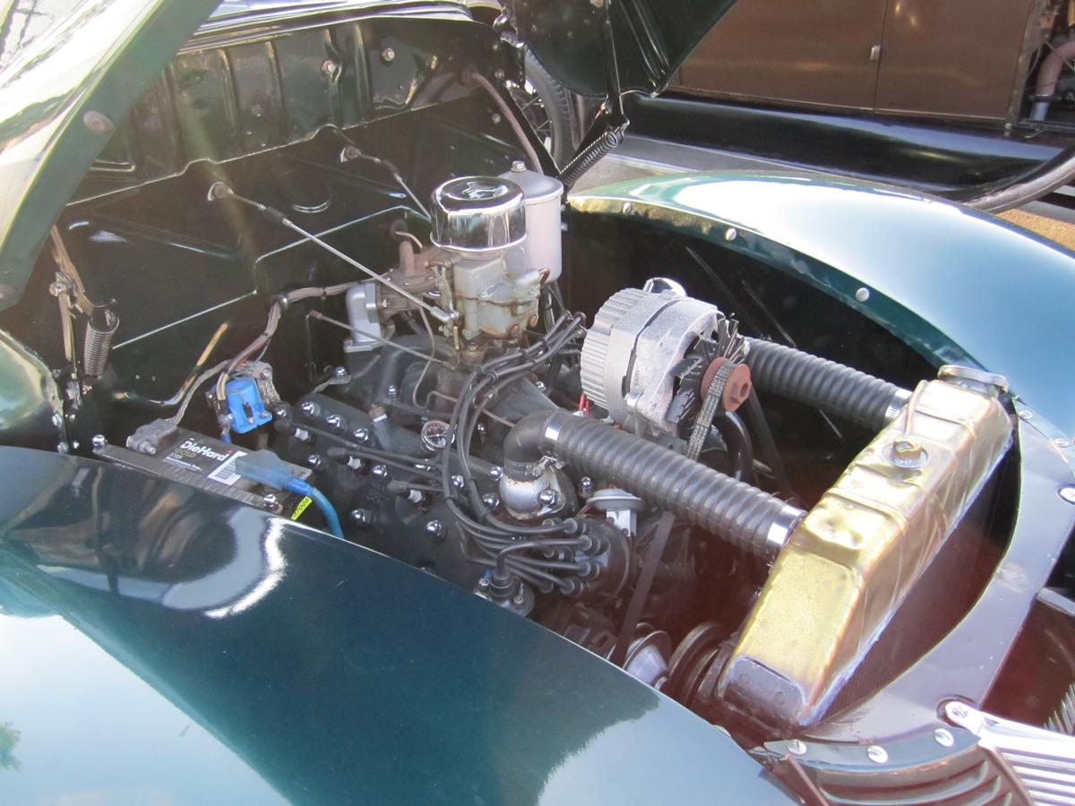

I have a photo of an 8BA in a 1940 Ford. You are thinking 8CM. As you can see he installed an alternator instead of a generator. After I had talked to him for a while and commented on the 1939 center shift he had installed based on the long stick out of the floor and no column shift he said, "It has a Mustang transmission. I only clamped that on to the stub of the shifter to look authentic! I'm sorry, therefore, I have no images of the underside or guidance there. I also found this with search on this site. https://www.earlyfordv8.org/forum/printthread.cfm?Forum=18&Topic=10205
This message was edited by therunwaybehind on 7-28-19 @ 2:37 PM
