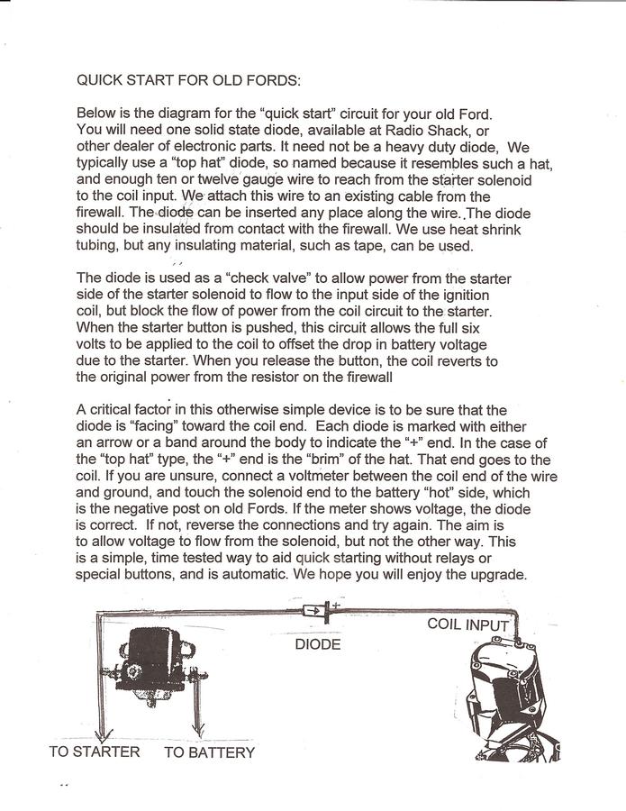

When the complaint is "won't start when hot, be sure to say if the starter is cranking the engine as when it is cool, or is cranking very slowly when hot. The starter gets hot when the car is use, causing high resistance in the winding, lowering current which, in turn, starves the ignition system, reducing spark. We use a "hot start" circuit connecting the coil to the starter motor side of the solenoid, with a diode in the middle of that link. This boosts the power to the coil. Many later cars did the same thing via a pole on the ignition switch or starter. Many years ago I posted he diagram here on the Forum. If anyone wants it, I'll dig it out and repost it.

I'd like to see it, Supereal. Thanks.

Supereal's resistor bypass circuit pictured/attached below....

Thanks MG. I am still searching for the original. I had it on my old system, but switched from Dell to Mac, and I am still trying to add from one system to another. The "hot start" works fine. The only complaint I've had is when the diode is reversed. I address the problem on my instruction sheet. The diode is a sort of "check valve" that allows power to flow to the coil, but prevents it from trying to run the starter. The circuit doesn't handle high power, so the diode doesn't have to be heavy duty. Just be sure that it "faces" correctly with the plus end toward the coil.
