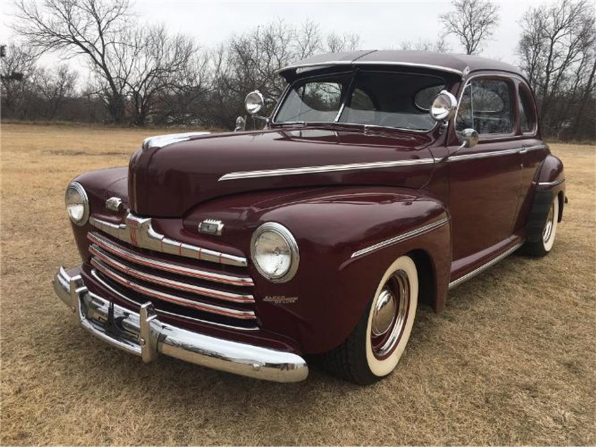

I'm looking for info on the front fender emblem that says "Super Deluxe". I believed it might have been used on the 1946 models and maybe some 1947 models (but which ones?). Where does it go (left front fender)?

I have done some research on the early 1947 5-window which almost did not exist. You can find it's story in the Club's book if you dig into the timelines. Now it would probably have been a Deluxe and have that text in diagonal on the left front fender face under the headlight with no underline. It would be a 77A. It would have no side window surround trim like the 46 Super Deluxe. For a SuperDeluxe before the April facelift to the 1947 look it would probably be a Sedan Coupe and thus a 77B . Now it is time for the real expert to chime in as I have seen both Super then an underline then below that Deluxe on the front left fender under the headlight and SuperDeluxe with no underline in the midheight. Photos on the Internet are notoriously identified so find only outliers there. To be a 1947 title it would have to be after February. To have lever shocks and not direct acting tubulars it would have to be before the fall of 1947. My POV is owning a 1948 which had a 1946 rear bumper with the Ford script in an oval as a stamp and one 1947/48 hubcap and two 1946 hubcaps. It definitely had the fresh air heater duct that came late in 1947 and the tubular shocks and two Panhard bars front/rear and a track torsion bar in the front suspension. (Note: the apparent photos are my renders of my flat fender Ford 3D digital coupe model. I do have a Tudor but it is a late 1947 with the 1946 hood ornament and late smooth un redlined trim and a G series six that the Ford dealer wrecker driver gave me in 1965 to take a fender off after I hit a deer.)

Are you sure that you have a '47, and that it is supposed to have the "Super Deluxe" on the fender? The reason I'm asking is that the '46 did have it on the fender, but in '47 it was changed to a square(ish) badge on the front of the hood. Given that Ford was notorious for bringing out changes well into the new model year, I will never say that it is impossible to have a '47 with '46 characteristics, but it would be (I would say) a rarity. Of course, another possibility (if you don't know the car's history) is that you have a '47 with a '46 fender. The fenders are interchangeable from '41 through '48, with chrome being the only difference.

There are 3 versions of 1947 Ford. The earliest has the Super Deluxe emblem on the fender and looks like a 1946 Ford. Around March 1st of 1947 the version which has the emblem on the hood but no hood ornament (bull nose, they did exist. I had one). Shortly after they started putting the hood ornament on.
