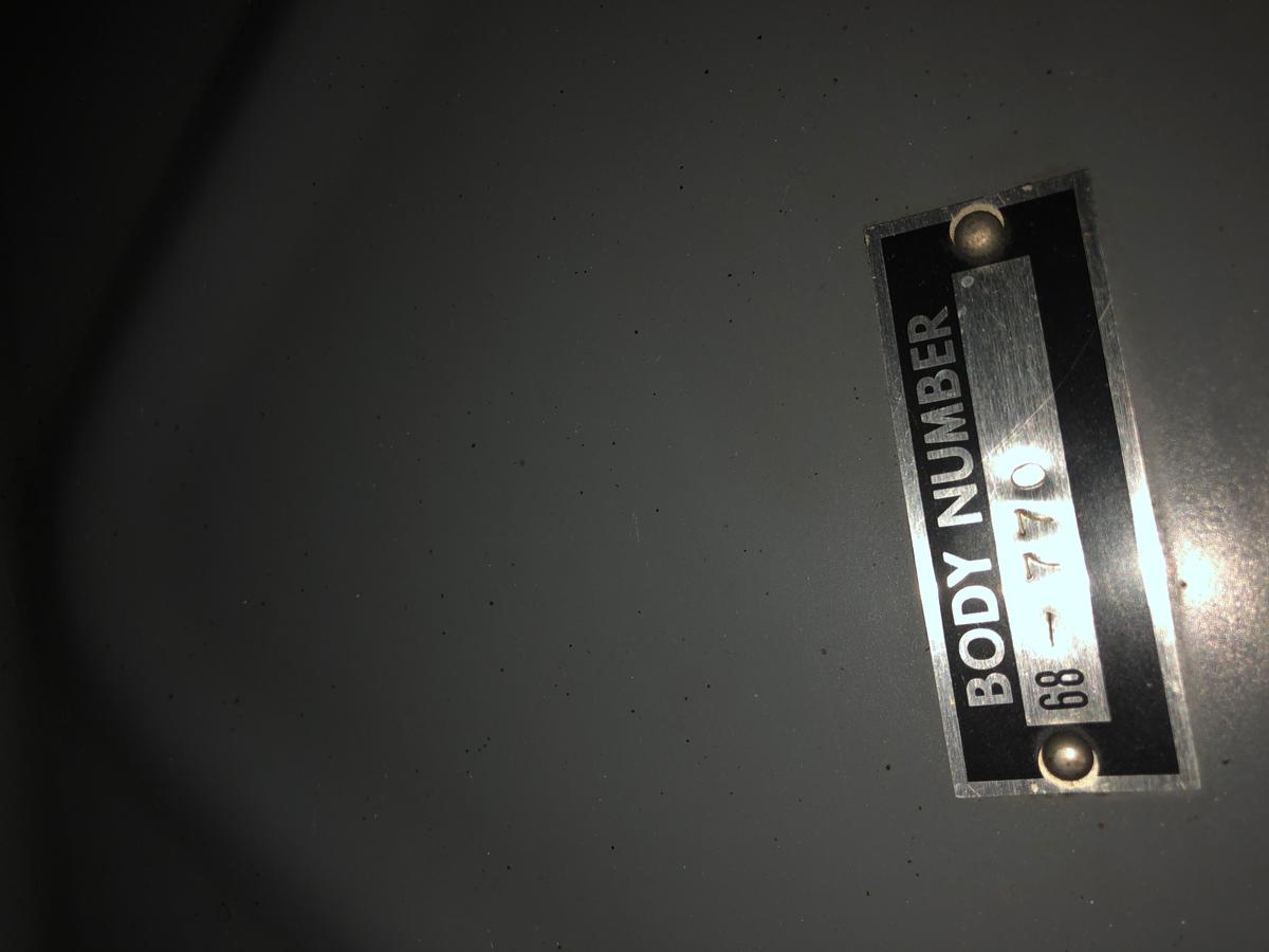

What does Body number 770 mean?

There's a few things worth noting in regard to your tag.
1) It is obviously not an authentic tag.
2) I am not 100% certain, but I do not believe any coupes received a tag. Only bodies supplied to Ford received tags. I am quite certain (not 100% though) that all coupe bodies were manufactured by Ford. Thus - no tag.
3) Authentic tags indicated body style and sequential manufacture of that particular body. the "770" on your tag indicates a five window coupe. There should be a dash and then another set of numerals directly after that "770".
That "68" on your tag is indicative of model year. In this case, 1936.

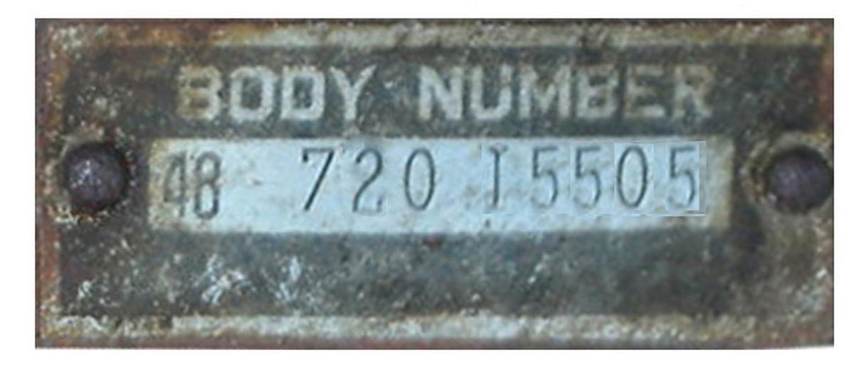

Your repro body tag is incomplete and should have additional production numbers after the 770.
Murray did make most, if not all of Ford's 3-window(720) and 5-window(770) in 1935 and 1936. Their bodies would have had a body plate and it looked similar to your reproduction. Enclosed is a photo of what I believe to be an original 1935 Murray plate for a 1935 (48 prefix) 3-window coupe ( body #15505).

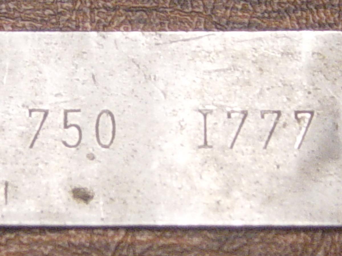

My 36 5/w has a body tag 770 8958 no dash only space.
Frank
