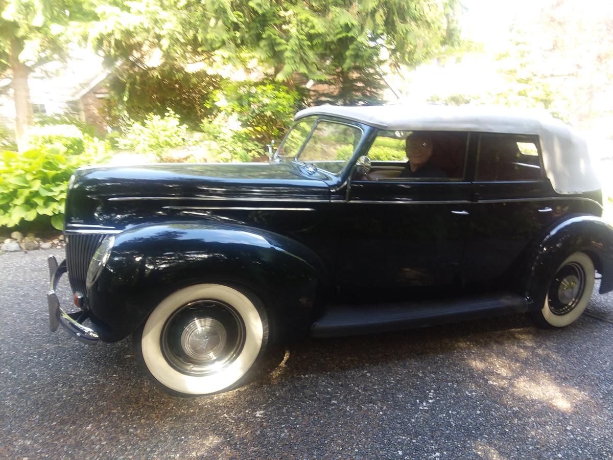

I took delivery yesterday of a 1939 Ford Deluxe 4 door convertible. I live in Mill Creek Washington, immediately south of Everett Washington.
I'm looking for;
Vendor near where I live that lube/change oil - need a brake job, the passenger window does not crank all the way up. Also, where to buy windshield wiper blades?
I was told their is an additive to the gas to doctor the unleaded gas we have now days
