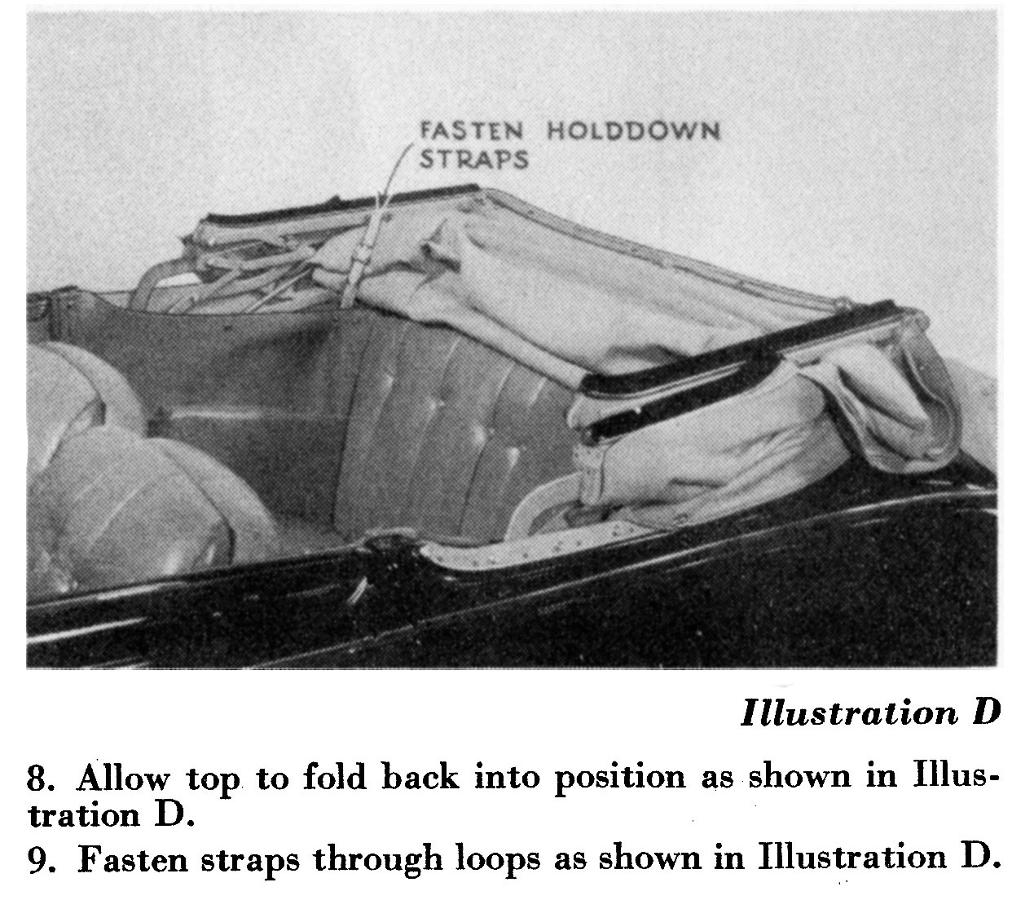

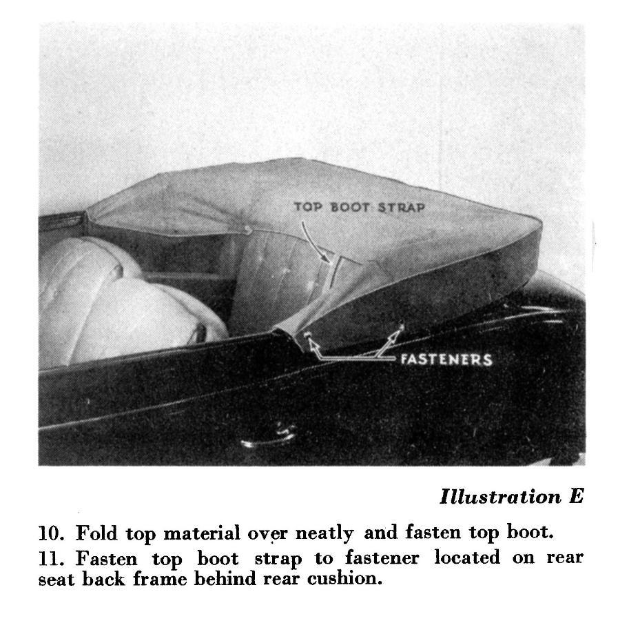

Don Rogers
05-28-2019 @ 5:08 AM
Posts: 512
Here's some photos from the top lowering instruction book.
jakes
05-29-2019 @ 4:03 AM
Posts: 35
Joined: Feb 2018
Don, thank you very much for these photos. I now can see what I need to do to install the boot.
Thanks again, Jakes!
