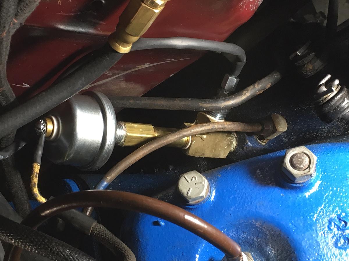

Jay I'm not sure how a '40 compares to a '46, but I just went through the process of working on my oil gauge sender. The PO had removed the sender and installed a mechanical gauge. I wanted the dash gauge working and still have the mechanical gauge as backup. I couldn't access the back of the oil port on the engine with the floorboard out, so had to do the job from the engine compartment. Still have bruises on my chest from laying over the fender. I have a set of 3/8" drive crowfoot wrenches, that along with an extension allowed me to work from the top to do the installation. I got some brass fittings from a plumbing supply, which I combined to have both the mechanical and electric gauges functioning. A short nipple and a tee fitting gave me the two ports I needed to do this. Orienting the tee and the mechanical line to clear the throttle linkage arm took some thought, and I had to realign (bend) the oil line that goes to the filter so it would clear the electric sender.
