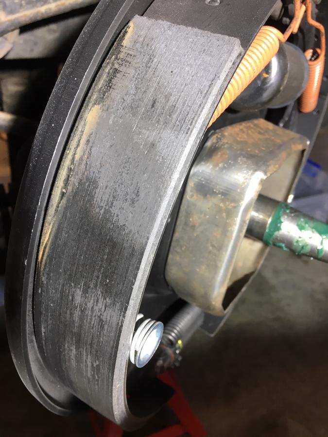

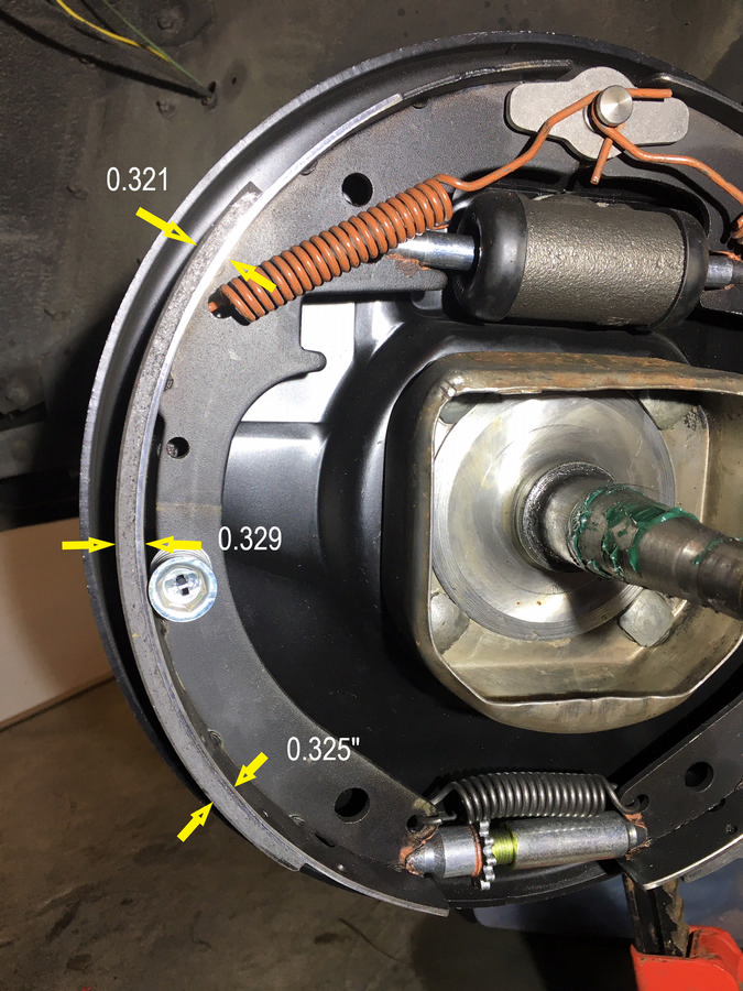

When I did my front brakes a couple years ago, I had the drums turned down and then I arced the shoes myself with a hand file. Seemed like a pretty simple, straight forward task. I started using a feeler gauge, but found it was pretty much just done by eyeball to get the shoes to the contour of the drums for uniform, maximum contact. Did I make an amateur's mistake here? Is there more to arcing the shoes than I know?

05-21-2019 @ 3:25 AM
Jay When there are no resources, be resourceful. The new shoes I installed on my '46 didn't make full contact for the full face of the linings. I determined this when I pulled the drums after driving the car a bit. I used a sanding block with 120 grit paper, to remove the high spots. I will probably have to repeat the process a few more times to get a good shoe to drum match.
