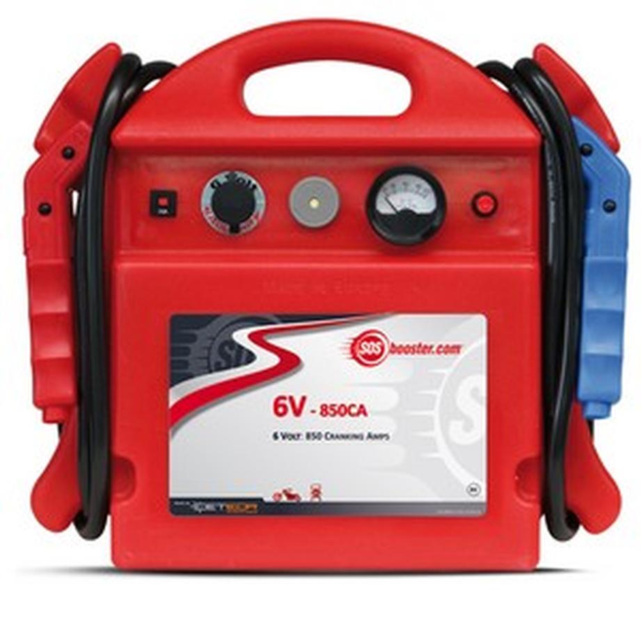

I have found one on internet by a Schmaucher division. Here is the link:
https://www.ceteor.com/en/boosters/lead-technology--agm/ceteor/sos-6-and-612v-range/jump-starter-sos-6v-850ca
Now to find a dealer that will order one (or more--others might want one from me!).

JC, I don't believe that the product is available in the USA.
