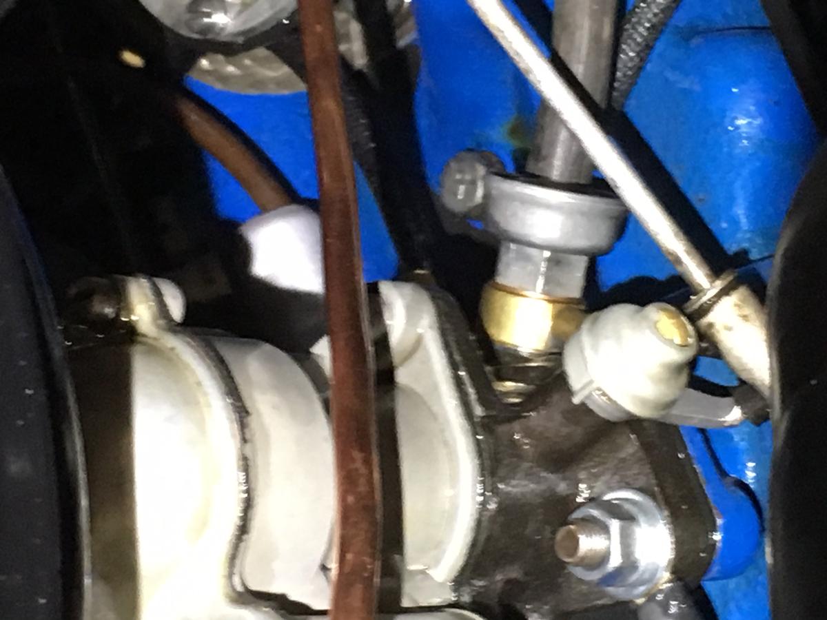

Does anybody know the part that inserts into the banjo of distributor vacuum line 21A-12226 (photo attached) and feeds the wiper hose?

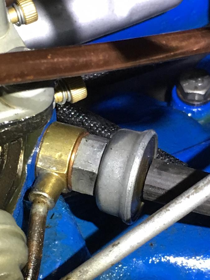

MICHV8 I think the attached pictures of my '46 engine is the part you are asking about. I looked in my various books, but could not come up with a part number. I don't know why the pictures turn side ways when included. One pic turned one didn't.

51woodie, That is exactly the part I need...nice photos too! Thanks. 41-42fordadvisor, I have a supposed original 39 flathead and will take a photo as I'm sure it has the same configuration as 51woodie photos. The history of the car is known, but maybe something was done. Thanks Fred for the part number...does anyone supply them?
