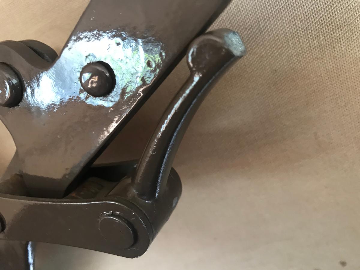

On my 1938 Ford deluxe convertible sedan both levers that stretch of the rear quarter panels are broken off. Does anyone know where this part would be available? Does anyone have a solution other than replacing the parts?

I do not understand your question, could you please post a photo of the area of the car with the broken part?

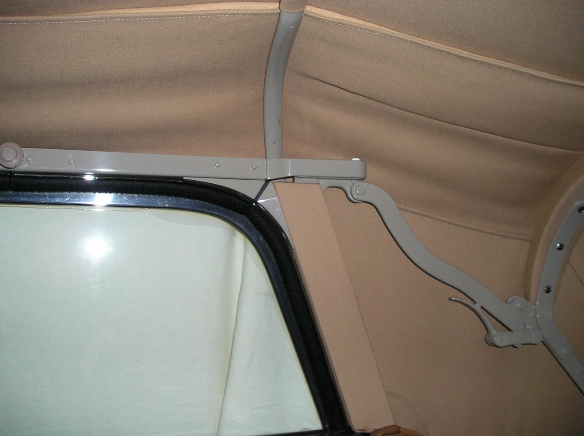

Thanks for the photos. I am sorry that I cannot offer any help, because I don't know where you could get replacements either.
3w2
03-30-2019 @ 4:20 PM
Here one is in a '37 cabriolet.
