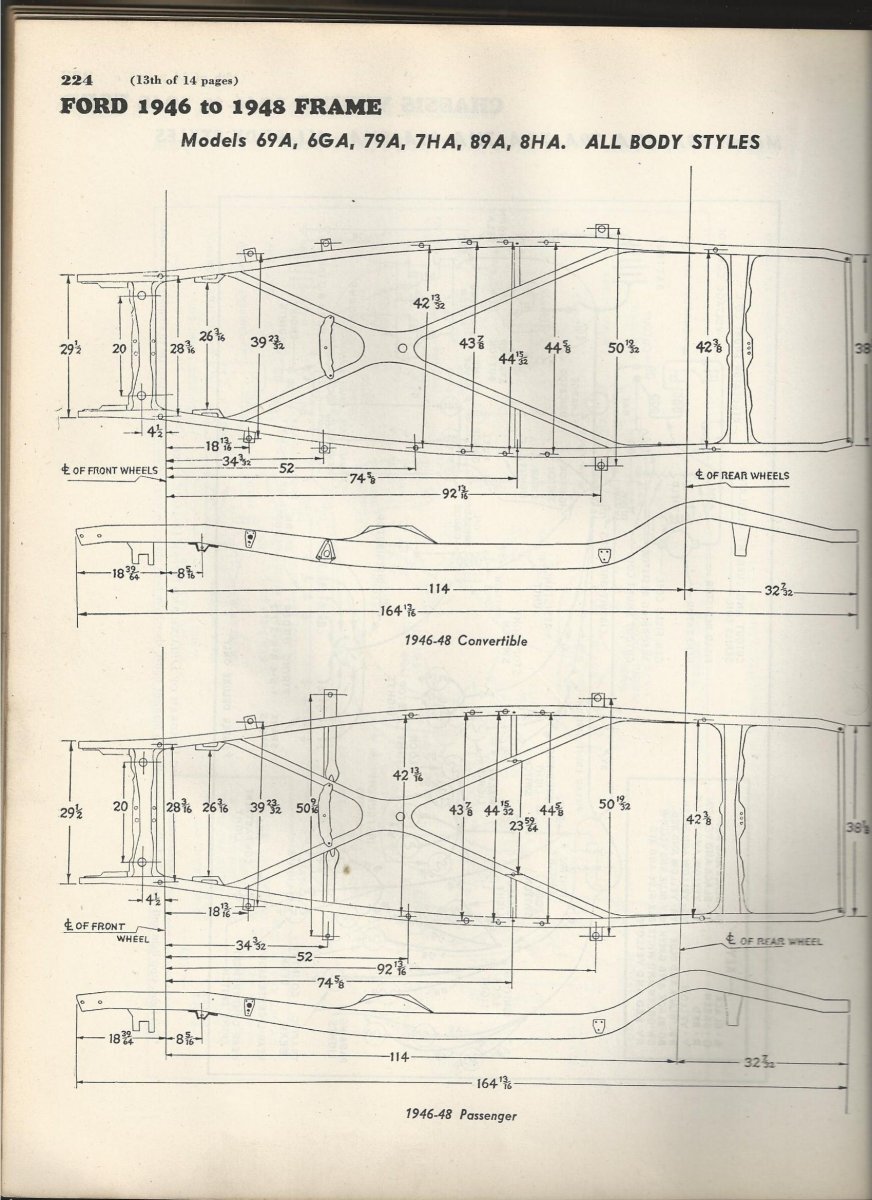

I am building a large scale 1 1/2 " per foot model of a 48 woody wagon. I am on the frame and need the measurements for the front cross member. I have all of the other measurements. As many numbers that I get would be great. I am a member of a car club in Colorado with only one 40s car and it has a Mustang front end. Thanks

Ritzy1 |
02-10-2019 @ 3:46 AM
Posts: 46
Joined: Sep 2014
Here's one that I came across somewhere.

I got my info. to the question, so thanks
