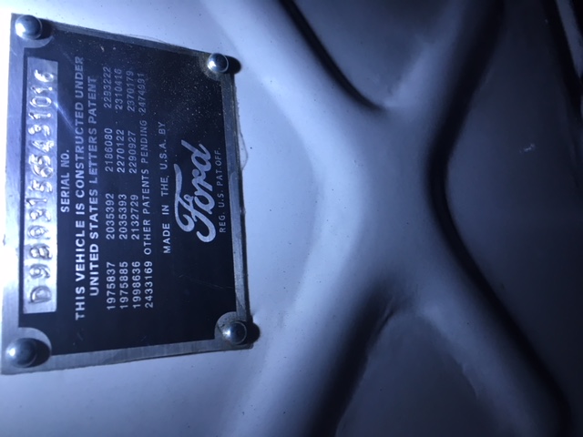

I found that number on the firewall on a plate that has this # D9B931565431016 the car I was told is from eastern Canada and is now in the west in BC The plate reads the serial No. then this vehicle is constructed under united states letters patent then a bunch more sequences of numbers then made in the USA by ford Reg.U.S.Pat. Off. I have not seen a number on the frame and it doesn't have the original trans housing.

Ford in the US did not put serial numbers (VIN's) on plates, they were stamped into the frame and transmission. Does it look like this plate from EBAY? A picture would be nice. Does the title match this number? I would suggest you keep looking on the top of the drivers side frame rail. It might be faint. Be careful not to destroy it while scr*pping paint. If it is not registered/titled I would expect you may end up lifting the body to see the numbers. Of course I am basing this based upon what I think the California DMV would require. Be sure to get the title clean before you invest ANY money in it.

here is a pic

so yes it looks like some one has put there own plate with that #

That sure looks like EBAY (or equivalent). If nothing else it looks too new to be original. What does your title say? Did you find anything on the frame?

Nor is it a Canadian VIN of the period. If the engine was rebuilt, some jurisdictions require/required a new VIN to be issued. What matters is the number on the title for purposes of registration and licensing. If the number on that plaque matches the paperwork, it matters not what the original number was even though that may well still exist stamped into the top of the left side chassis frame rail. It would commence with 'C18........'

Yes I believe your right I think when the car was down east they issued a new vin. my paper work is ok because my Province
did the same thing issued it a Provincial vin # .I can't seem to see one on the frame but maybe because its been painted again.
