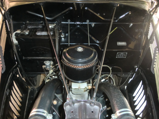

If I recall correctly, there should be two 'dimples' on the firewall to drill out for the correct "Tee-Bolt" location. You can see the two bolts in the picture I've attached below. In the picture they are located just below the bend in the firewall where it goes from an angle to vertical....

Thanks, your reply is very helpful. From your photo, is one of the Tee - Bolts located near the throttle rod? By chance could you also take a view of the underside of the dash?
