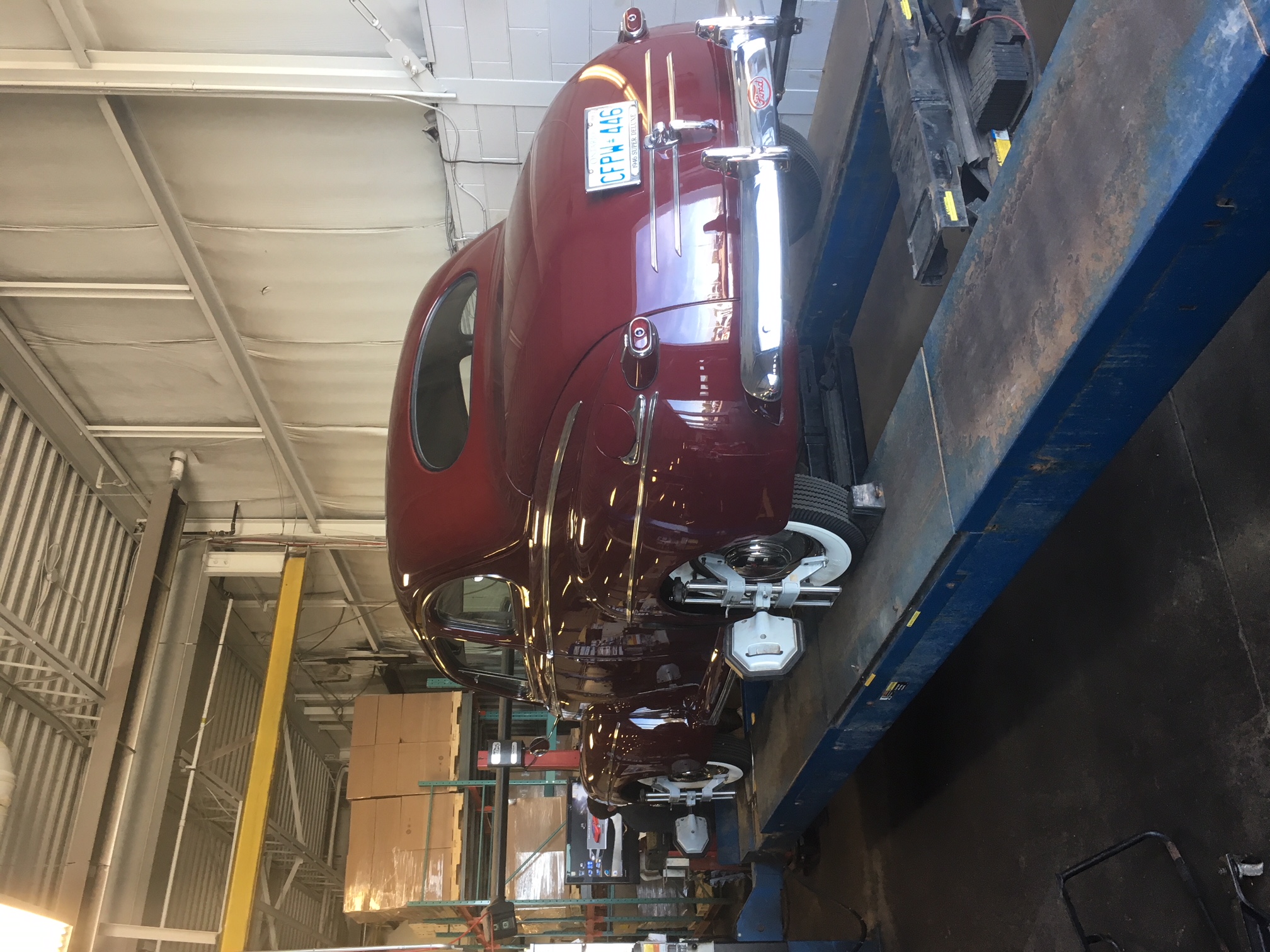

51woodie
12-04-2018 @ 12:36 PM
autoluke. I had a bit different problem, in that my '46 had a slight tendency to wander. All the front end was tight, as well as the rear suspension. I checked the toe in as best I could at home, but decided to take it the FORD dealer to have the alignment checked. All was good except for the toe in, which the Tech adjusted. Much nicer to drive now. The only challenge was for the Tech to convert the inch dimension spec to degrees for the alignment machine. I guess my measurement was not accurate enough.
