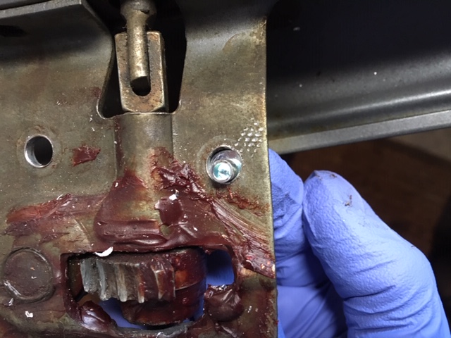

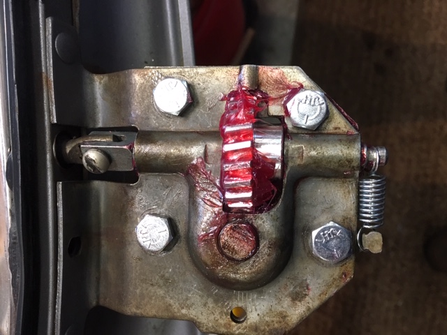

Both vent windows had stripped gears when I bought the car, I purchase two kits, 11A-7023402-GR, (made in Taiwan) from DC. The gears in the kits were excellent and fit very well. The rivets were too small 3/16" vs 1/4" dia. and almost too short to peen over even if they were the right diameter. The springs in the kits were the right size, but lacked I tension compared the original spring. I couldn't get 1/4" rivets locally, so I used 1/4"X3/4" NC bolts and locking nuts. Assembled nicely and the window/cranks work just like new.

here is your second picture

51woodie
11-29-2018 @ 7:41 PM
John. I thought that may be a problem. but if you look at the picture you will see that the bolts are put in from the door skin side, as there is enough space for the threaded ends on the crank side. The frame/trim went back in place, no problem
