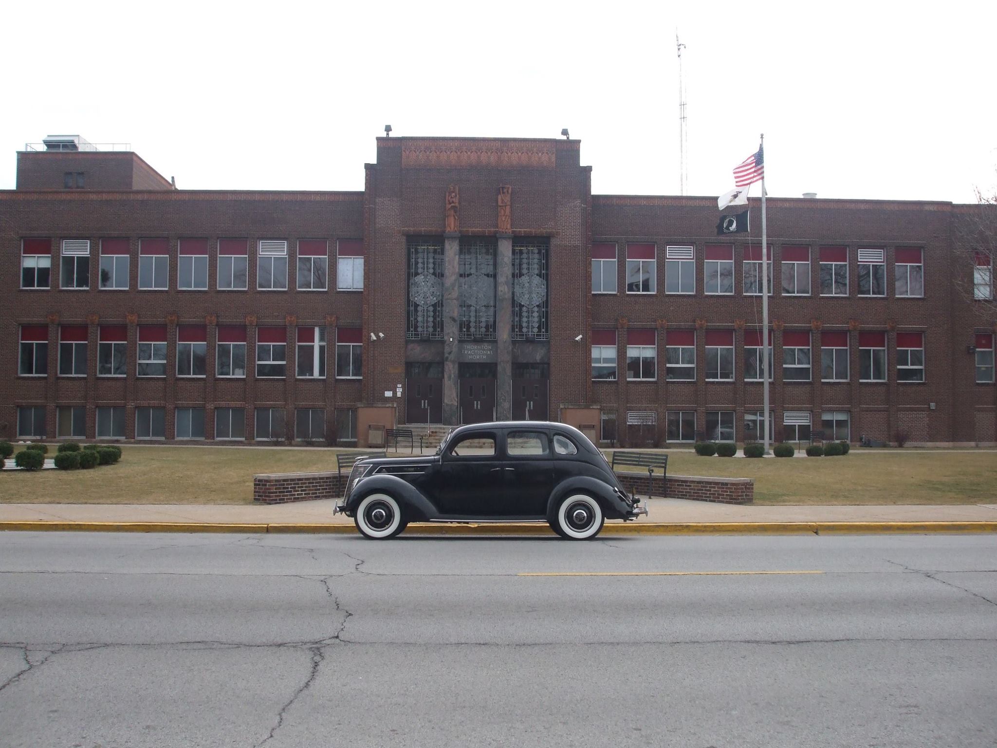

MG,
I drive my 1937 Ford during the winter months as long as there is no snow, ice or other adverse conditions.
Here is my 1937 Ford on Super Bowl Sunday a few years ago (Chicago / Northwest Indiana region).

Tony....I love the looks of '37 Fordor Slantbacks!

Tony, i too love your 37. Nice nice car !

Looks good Tony, drove my 36 in winter also as long as no salt on roads. They were not ment to be sunny day cars. ken ct.
